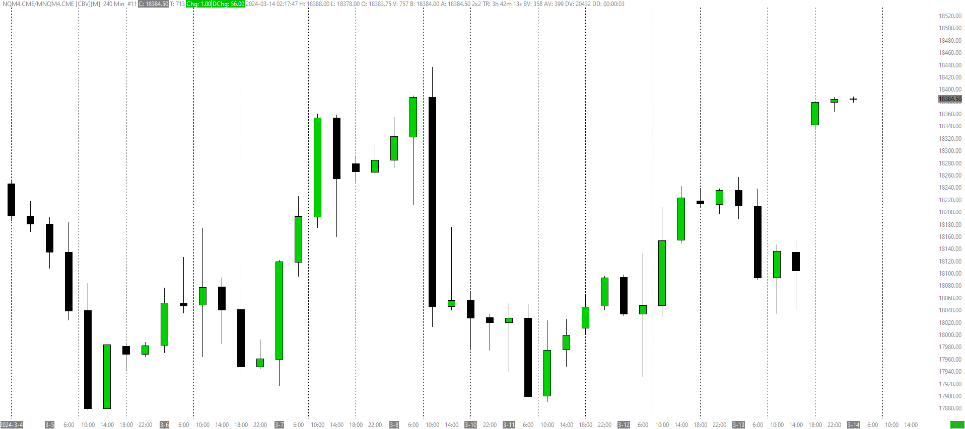

I am attaching a chart of the NQ after I rolled over to the june contract. I have evertyhing set to continiuous contract backadjusted but there remains a huge gap between the rth and the eth session of 200 points.
I attached a tpo chart for you to have a look but this gap appears on all chart, incl. my other candlestick charts. I tried delete all data and download but the gap remains.
could you please have a look and tell me if thats normal behaviour? For me it would be the first time ever to have such a gap after rollover

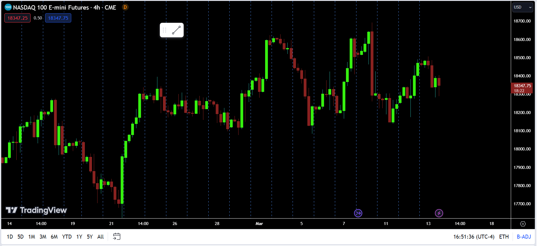

[2024-03-13 21:20:51]
maxm1987 - Posts: 136
https://www.sierrachart.com/image.php?Image=1710364286285.png
please see attached the image of a 4 hour candle chart which a 240 point gap betwenn the close of the 2 pm candle and the start of the 6 pm candle on march 12. Also note how the high comes in at roughly 18500. Now compare that with the screenshot of a tradingview 4 h candle chart for the same time, there is no gap during this time and there is a high of 18700. Both charts show the june contract and are back adjusted.

[2024-03-14 06:22:34]
https://www.sierrachart.com/image.php?Image=1710397074159.png
hi there,
referring back to the topic it is now getting even more confusing for me. Take a look at the provided link. the image for nq now shows no gap during the 12 and 13 of march after starting my charts back up, whats now confusing for me is that it shows yesterdays high at roughly 18240 instead of 18500 in my prior screenshot.
And now instead of the huge gap from yesterday there is a 250 point gap in the screenshot i provided... so basically the gap moved one day further and the high is now totally different. IB and tradingview show consistent prices.. please advise

[2024-03-14 10:01:45]
Refer to:
Please Read: Continuous Contract Rollover Issues

[2024-03-15 03:52:30]
Regarding post #8, what we wrote is not necessarily in regards to the images you have posted. We have so many users and so many postings, we cannot keep track of everyone and we do not know who is who when answering questions.
This image you posted does not show the vertical line with the month and year showing the new contract month:
Unless no rollover occurred on any of the visible dates.
Regarding post #9 we will see about that. We do not want to make disruptive changes. And actually that is not going to matter, with the volume-based rollover. And changes, to the rollover date, affects prior rollovers in the past.
