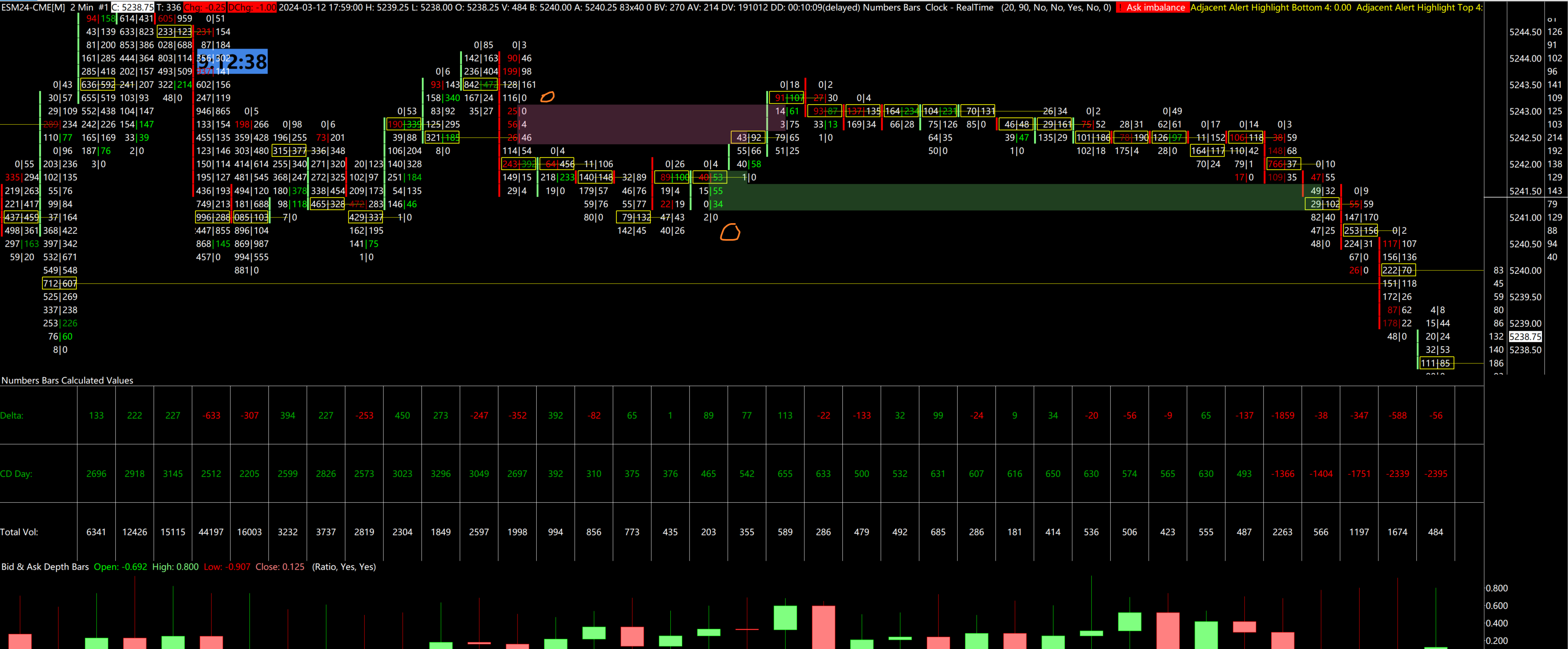

I want to make spreadsheet system for trading. How to get sum of 5 levels Ask size and sum of 5 levles Bid size through study? So that I can subtract or divide the two values. I mean not use ACSIL
thanks.
as you can see in attachment
imageAsk+Bid.png / V - Attached On 2024-03-12 17:56:43 UTC - Size: 183.48 KB - 355 views
[2024-03-12 18:12:25]
To get the sum of just 5 levels of Bid and Ask do the following:
- Set "Chart >> Chart Settings >> Market Depth >> Number of Levels for Bid/Ask Depth Calculations" to 5.
- Add the "Bid and Ask Depth Bars" study to the chart twice.
- Set one copy of the study to have an Input for "Sum Bid Side" and the other for "Sum Ask Side"
The Close of the Bid and Ask Depth Bars studies will give you the 5 levels of depth for each side.
Refer to the following for more information:
Chart Settings: Number of Levels for Bid/Ask Depth Calculations (Chart >> Chart Settings >> Market Depth menu)
Bid & Ask Depth Bars
