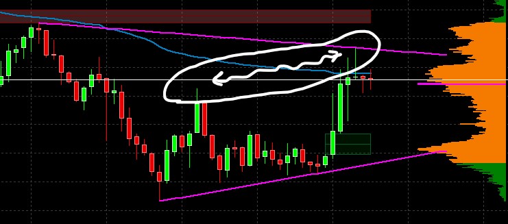

In an uptrend the auto trendline only draws the bottom 2 point touches. Is there a way to have it draw the top 2 point touches at the same time. See attached pic. Or possible an auto parallel trendline. Thanks for the help.
imageScreenshot 2024-03-10 095312.jpg / V - Attached On 2024-03-10 14:56:00 UTC - Size: 63.01 KB - 364 views

What you can do is to have a second "Auto Trendlines" study and set the following Inputs as shown:
- Input Data High: Low
- Input Data Low: High
So the Uptrends will look at the Highs and the Downtrends will look at the Lows.
Although we do not think this will give you exactly what you are looking for. If you really want the line to be at the highs of the same bars where the uptrend occurs, then you would need to modify the study to do what you want. Refer to the following:
