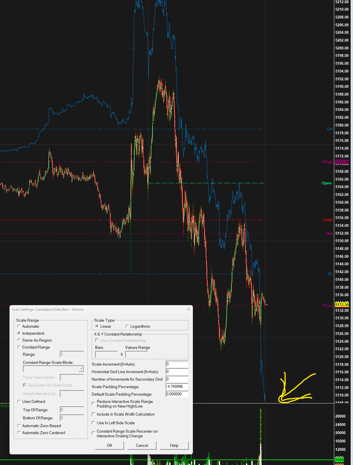

I have an indicator on chart region 1 as a line on close over my charts. I have tried the scale on independent and auto zero centered because it is Cumulative delta.
When I have the main chart scale settings as constant range the indicator would occasionally go of screen when it get's too high or too low.
When I have the main chart setting scale set to automatic it is fine however I prefer to have my charts on constant range scale view.
Is there any way I can continue to use this constant range view and not have the cumulative delta going of the chart?
I have attached an image
imageAdditional Symbol going of screen .png / V - Attached On 2024-03-09 16:40:31 UTC - Size: 169.69 KB - 185 views

To begin with, a setting of Constant Range is just what it says, it is a constant range of price levels that are displayed. So the size of the scaling does not change, therefore the Cumulative Delta will occasionally go off the screen.
For what you are doing, it would be best to use the Left Side scale for the Cumulative Delta data, so you can keep everything displayed as you want. Refer to the following:
Chart Scale and Scale Adjusting: Use In Left Side Scale
Chart Settings: Use Left Side Scale (Chart >> Chart Settings >> Scale menu)
