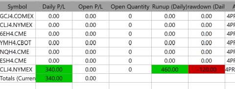

I've got a big problem with my Trade Activity Log. In generell it shows me a summary of all my trades and a summary of my daily PnL.
but actually it doesn't. i use the quote book, to switch between the markets and today, i made a trade in ES and CL. when i switch to one market, it only shows me the PnL of this market. When i switch to GC it shows me i haven't traded today. It's 0 (zero) everywhere.
What have i done? or the better question, how can i solve this, so it shows me in every market the actually PnL of other markets, like it should in general?
imageExample 1.jpg / V - Attached On 2024-03-05 15:09:28 UTC - Size: 30.8 KB - 257 views

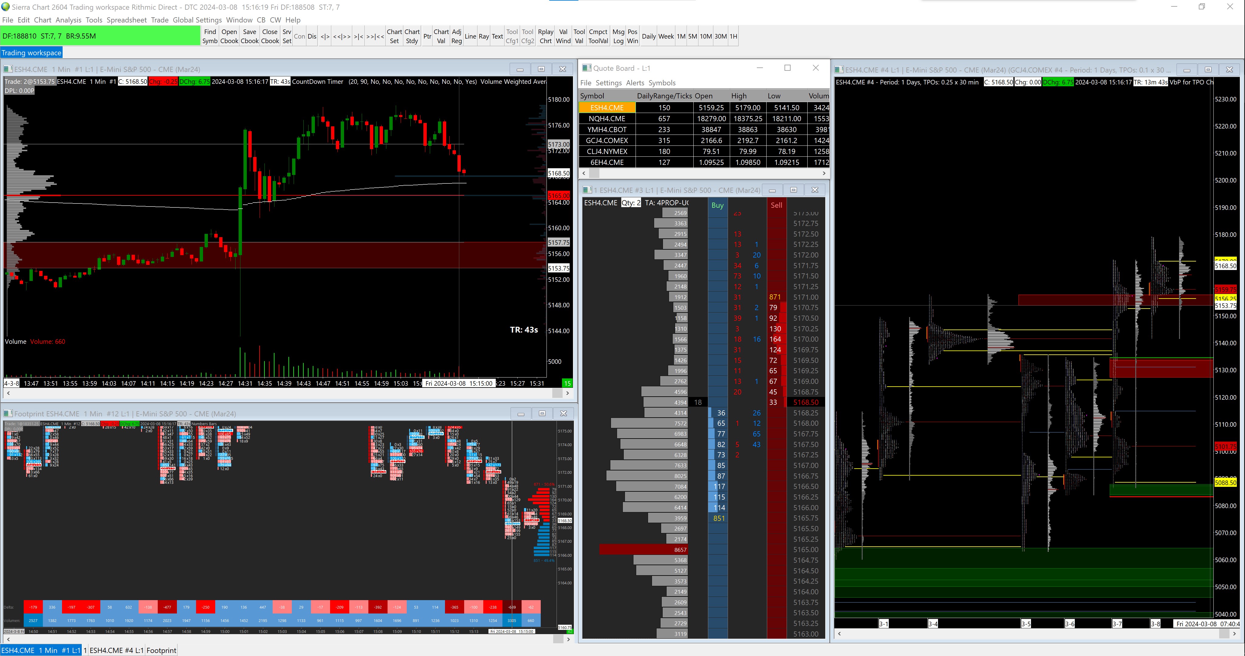

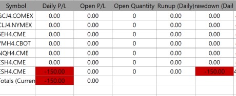

in Example 1 you can see CL, in Example 2 it's ES and in Example 3 you can see GC, when i switched them by quote board.
i closed and reopened the trade activity log, but it doesn't matter. same problem
imageExample 3.jpg / V - Attached On 2024-03-05 15:10:38 UTC - Size: 27.73 KB - 234 views

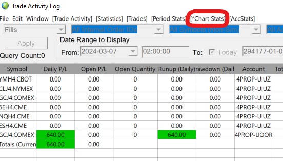

We assume you are looking at the "Chart Stats" page of the Trade Activity Log. As such, only the active symbol of the chart, at that time, will be what shows in the Trade Activity Log. If you use one of the other pages, then you will be able to see all the trades for all symbols from the same chart. But that specific page will not since it is chart specific. Refer to the following:
Trade Activity Log: Trade Statistics for Charts (Chart Stats) Tab

i've 3 monitors.
1st for execution
2nd for analyssing the market on the first screen
3rd to have an overview of all markets i trade.
in this moment i realise that when i get executed (beein in a market here ES actually) i also can't see the trade on my third screen.
i general when i got in a trade a saw it on the 3rd screen in the market and in the trade activity log in chart stats that i get filled and what is the PnL right now

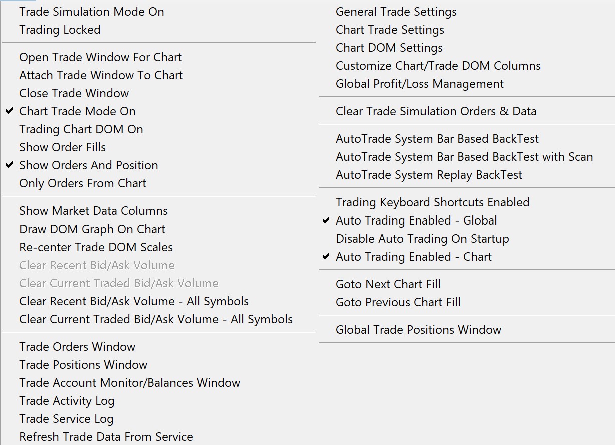

Also, make sure the option for "Trade >> Only Orders from Chart" is not enabled, or this will prevent the display of orders from other charts to show on that chart. Refer to the following:
Trade Menu: Only Orders From Chart (Trade menu)

User497465 - Posts: 42

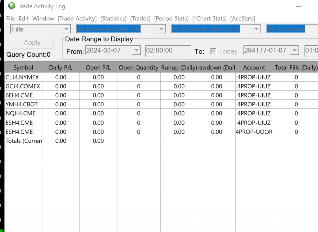

i used the trade activity log you can find here "trade>trade activity log".

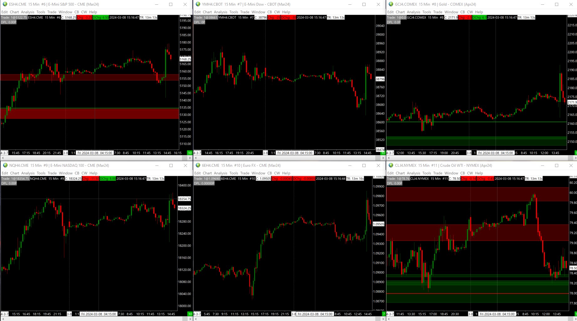

i use multiple monitors, but in only one running application. i only detached them to get them on another monitor (so they will be out of the main space, hope you understand what i try to say). i use the quote book to switch between the markets. when i'm using the quote book, only my execution and analyse monitor will switch to another market. my overview monitor has still the 15 min charts of the markets i use. in the next massege i will make some screenshots for you, that we have no missunderstandings.
"Trade >> Only Orders from Chart" is enabled.
like i said, some time ago, maybe a week is was working very well. for example i get filled in a trade in CL and now changed to GC i saw in the trade activity log my postion in CL and on the 15min chart on my overview monitor. i could exactly see what was going on and could react in the overview chart. at the moment it's different. same example and when i switch the market, my trade activity log is empty (there would be only shown older or active position of the market is switched to, here gold. but no other one. did i have a trade in ES and CL or which constellation you would image, it wouldn't be shown, until i switched to the market i was filled. but i can see only the market i switched to). Does i have 3 positions at the same time (CL, GC and ES) i can only see the open market in trade activity log and on my overview monitor. The other markets were looking like they don't exist or i don't have a filled position in it
imagetrade activity log.jpg / V - Attached On 2024-03-08 13:58:30 UTC - Size: 58.25 KB - 228 views

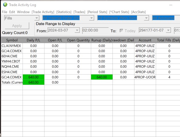

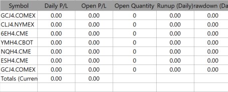

[2024-03-08 14:17:13]
to underline my example.
some minutes ago, id did a trade on GC. when i opened GC there is no problem. when i switch to ES it looks like these (have a look to the uploaded screenshots).
when it worked well, i could shwitch to ES and it should shown me the same like when i had GC open
imageGC.jpg / V - Attached On 2024-03-08 14:13:52 UTC - Size: 74.55 KB - 261 views
imageES.jpg / V - Attached On 2024-03-08 14:13:59 UTC - Size: 74.88 KB - 332 views

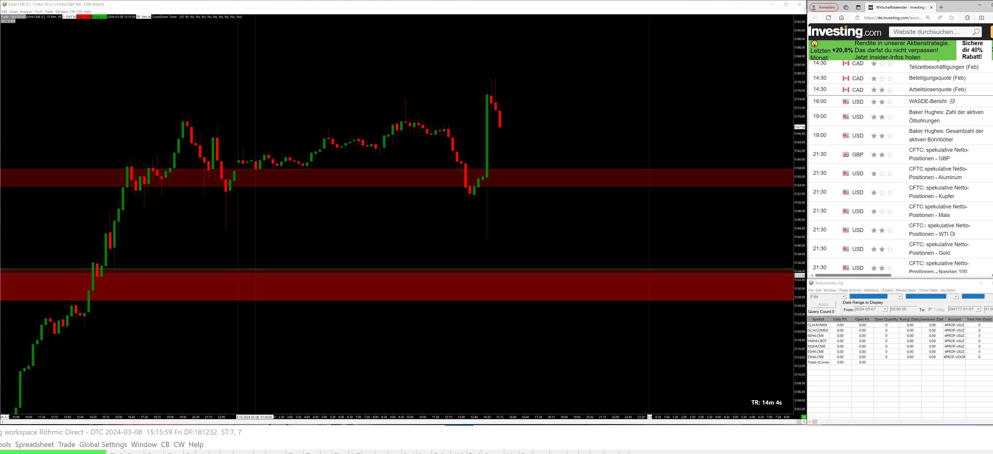

here my chart setup on the multiple monitors.
this is my sierra setup (actually beeing in ES that's why you can't see the PnL of my GC trade in the trade activity log, shown in the messege above "Screenshot GC")
imageanalyse monitor.jpg / V - Attached On 2024-03-08 14:18:14 UTC - Size: 489.81 KB - 345 views
imageexecution monitor.jpg / V - Attached On 2024-03-08 14:18:24 UTC - Size: 1.15 MB - 297 views
imageoverview monitor.jpg / V - Attached On 2024-03-08 14:18:30 UTC - Size: 288.68 KB - 307 views

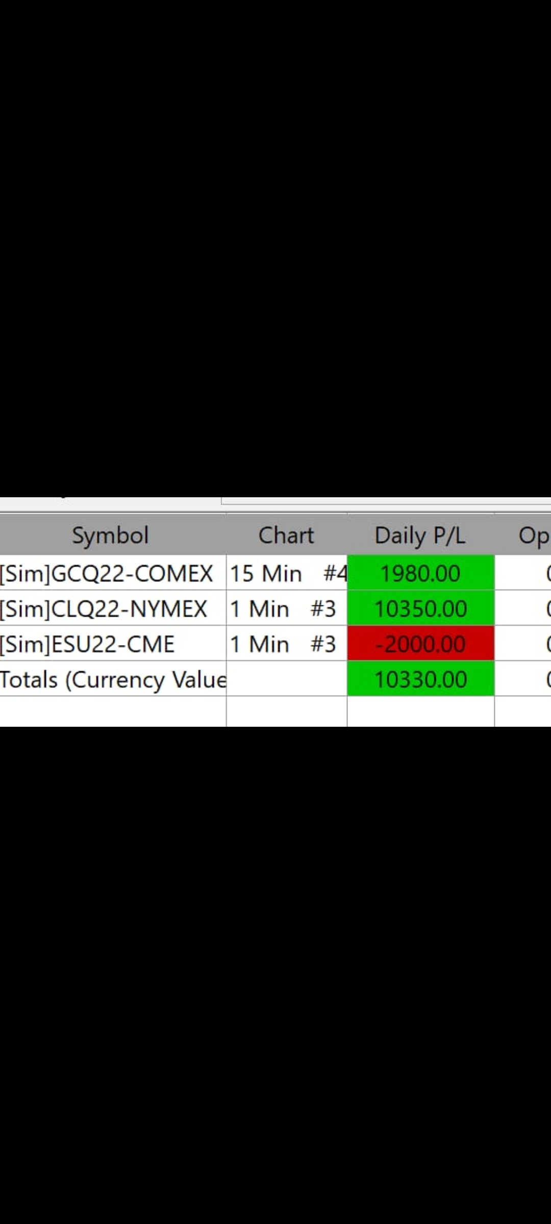

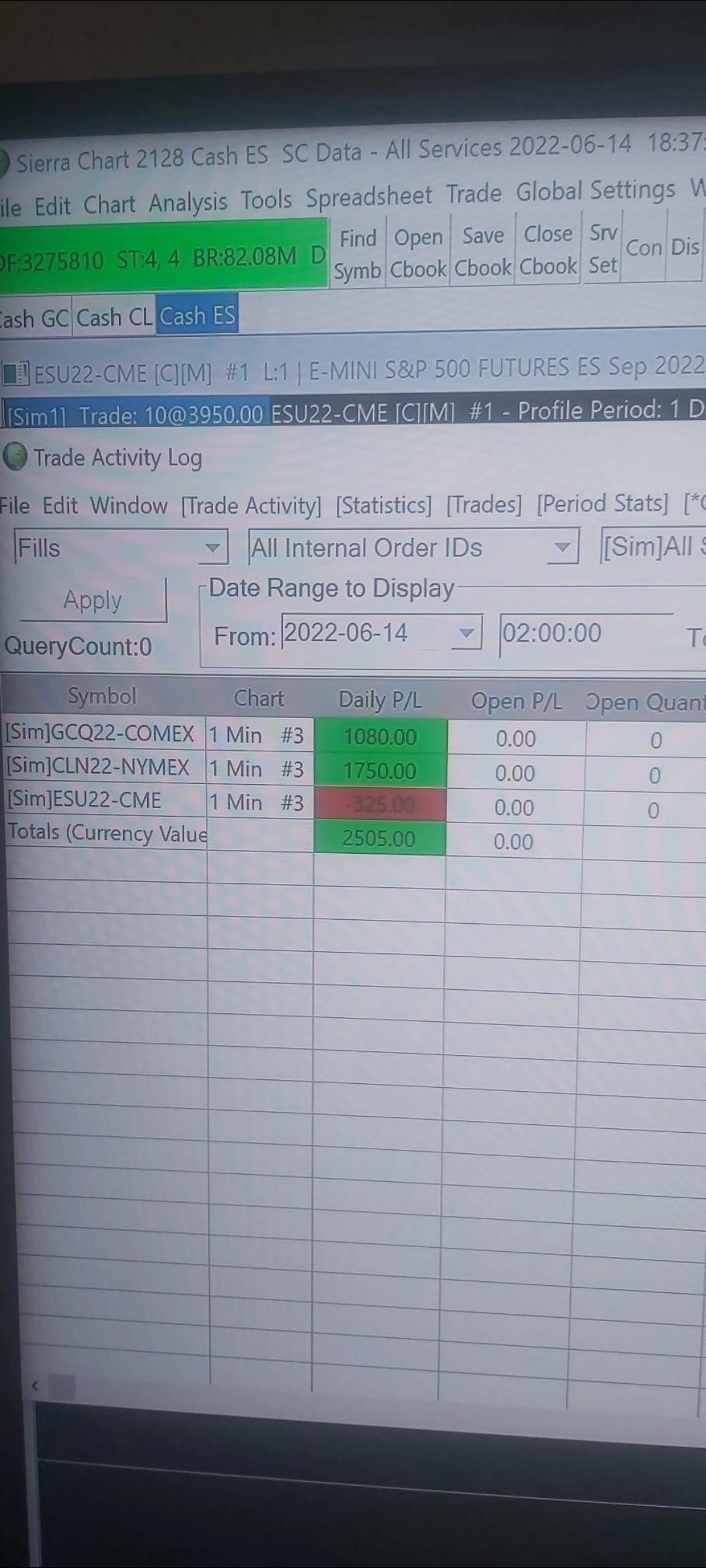

These aren't the best examples, but i want this back (screenshot)
imageScreenshot_20240308-154728_WhatsApp.jpg / V - Attached On 2024-03-08 14:56:07 UTC - Size: 215.79 KB - 224 views
imageScreenshot_20240308-154716_WhatsApp.jpg / V - Attached On 2024-03-08 14:56:14 UTC - Size: 861.76 KB - 303 views

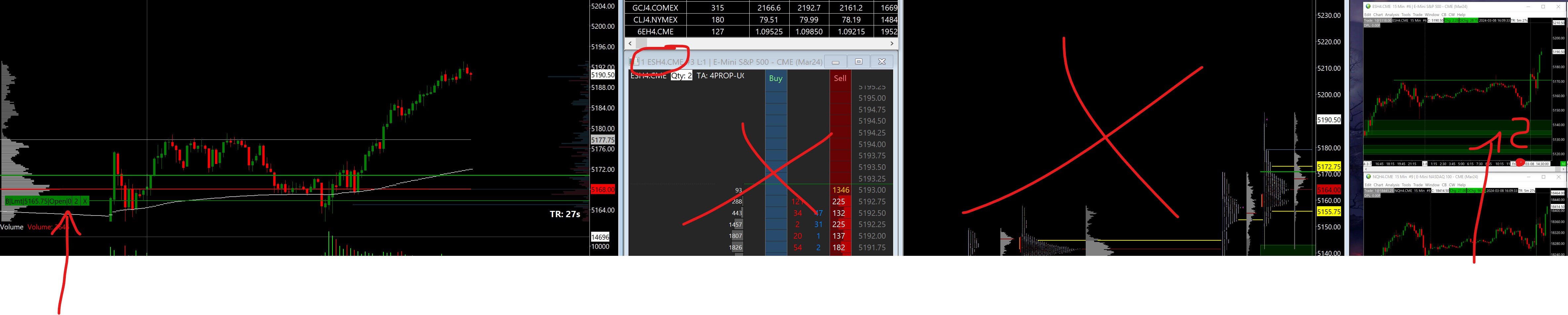

[2024-03-08 15:12:44]
here an example what i tried to tell you, that positions, orders, etc. are not shown on my overview monitor.
at the same time this happned, my trading activity log didn't show me the summery of all markets, only of the one market i had open on my execution and analyse monitor.
imagequestion.jpg / V - Attached On 2024-03-08 15:11:24 UTC - Size: 457.2 KB - 299 views
[2024-03-08 16:54:41]
You mentioned above that you have the option for "Only Orders from Chart" enabled. Make sure this is NOT enabled (i.e. disabled) by ensuring that you do not have a checkmark next to it. In particular, you want this for the charts in the other windows where you are keeping the 15 minute charts for each product.
From everything you are stating, this should resolve the issue, as you were not having those charts show any information. With the option disabled, those charts will show the information, and it will then show in the "Chart Stats".
[2024-03-11 13:24:41]
It's not activated (screenshot). in every chart it's deactivated.
but this doesn't solve my problem. i still can't see in the chart stats filled positions of other markets
imageonly orders from chart.jpg / V - Attached On 2024-03-11 13:21:13 UTC - Size: 224.38 KB - 302 views
