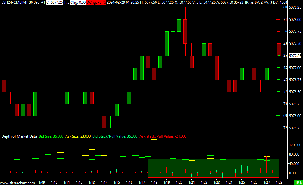

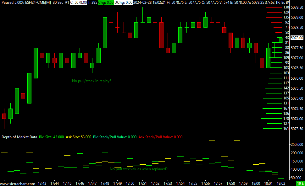

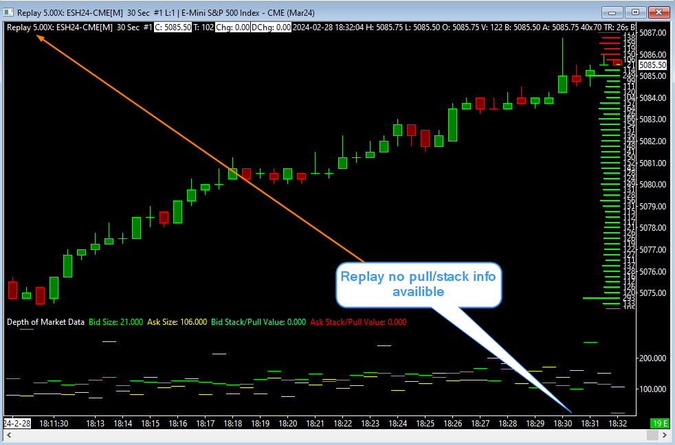

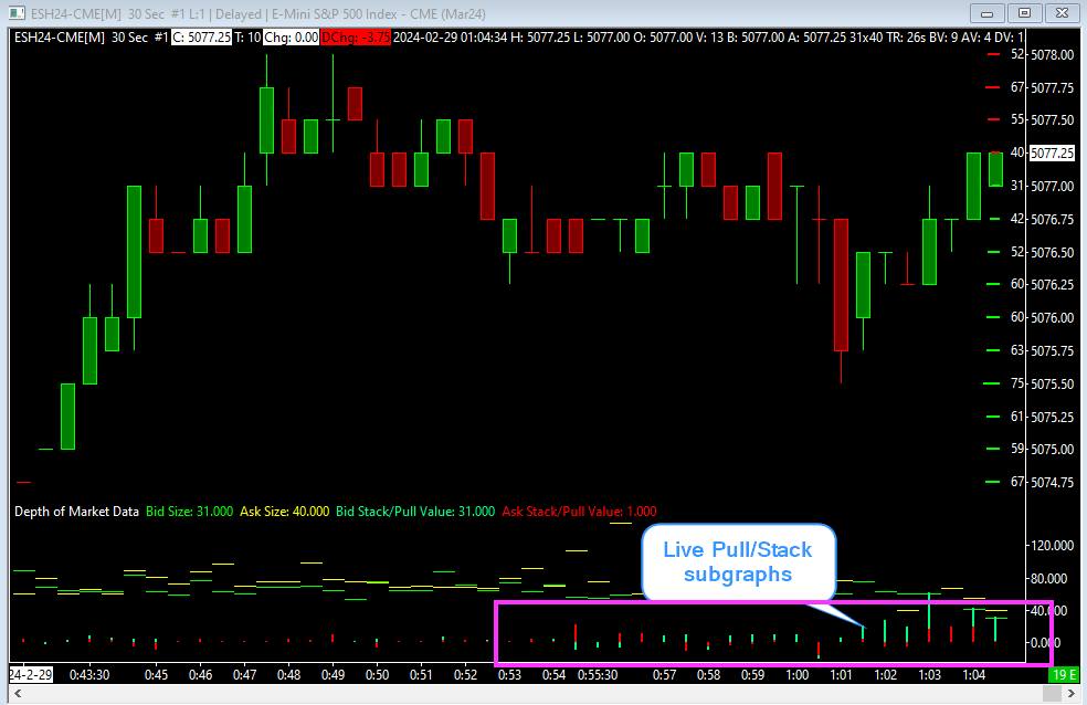

But when using a study that has sc.GetBidMarketDepthStackPullValueAtPrice() or sc.GetAskMarketDepthStackPullValueAtPrice() it doesn't populate with data. See two attached pics. One live the other replay. No data for replay.
https://www.sierrachart.com/image.php?Image=1709170958180.png
Is this meant to work in replay and I'm doing something wrong?
image2024-02-29 12_14_51-Sierra Chart 2568 PullStack LIVE 2024-02.png / V - Attached On 2024-02-29 01:37:37 UTC - Size: 42.78 KB - 194 views
image2024-02-29 12_14_36-Sierra PullStack REPLAY Chart 2568 2024-.png / V - Attached On 2024-02-29 01:37:43 UTC - Size: 46.25 KB - 214 views

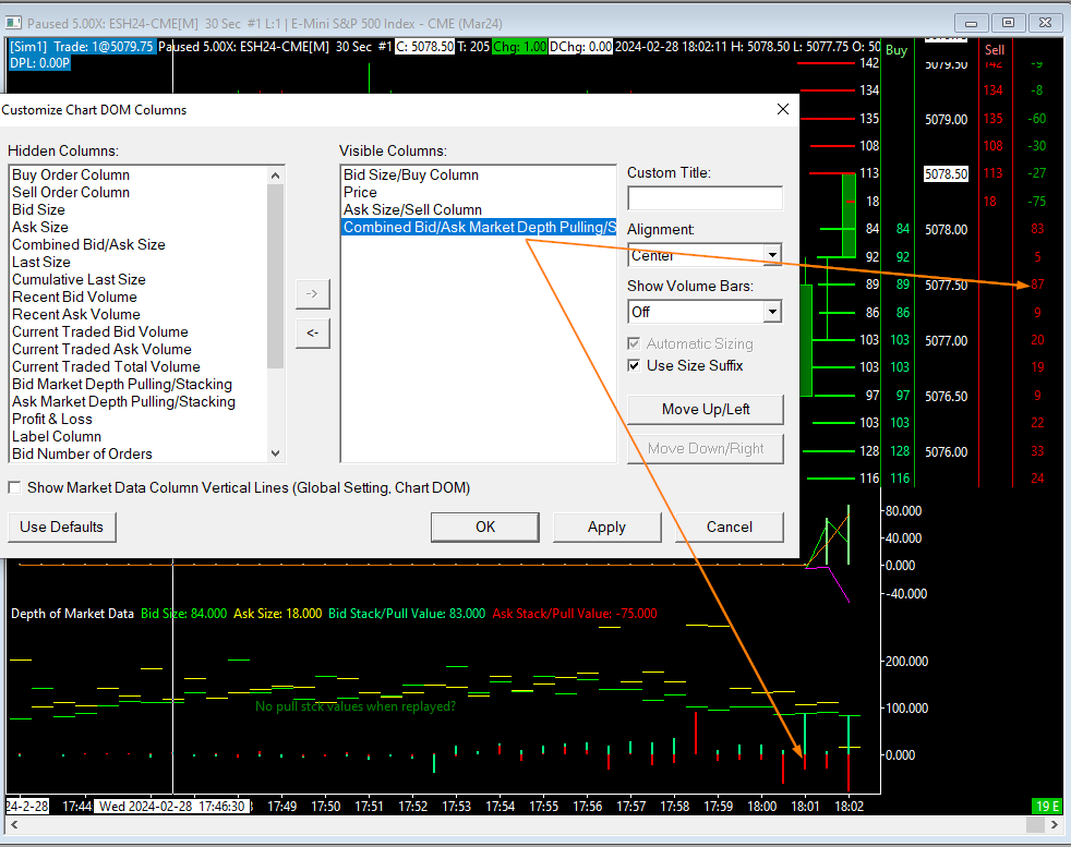

OK, for anyone else that's misses that in the docs. Have figured it out on a better read of
ACSIL Interface Members - Functions: sc.GetBidMarketDepthStackPullValueAtPrice()
You need the pull stack column to be showing in the Trading Chart DOM not just the depth.
