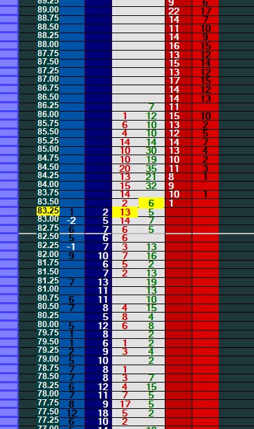

I have attached a pic of my dom, the outside red and blue columns are the pulling and stacking columns. I have them set to black color when adding and white when pulling. I can repeatedly watch the numbers and see a current bid or ask current number drop to a lower number and the pulling/stacking column color does not go white. It does not happen all the time and I have played with the 2 dom global settings, but this has not allowed any consistency of decrease in the color of white to show up any different way.
imageScreenshot 2024-02-27 112858.jpg / V - Attached On 2024-02-27 17:37:43 UTC - Size: 93.67 KB - 1124 views
imageScreenshot 2024-02-27 113825.jpg / V - Attached On 2024-02-27 17:38:50 UTC - Size: 89.31 KB - 698 views

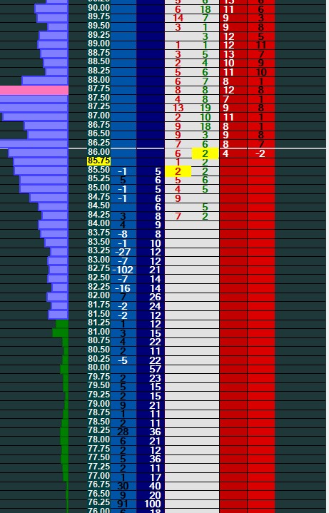

attached is a pic I just took. it shows the white numbers where the number has decreased.
New question, maybe where I am misunderstanding. My understanding is when the bid or ask decreases, the pulling and stacking number is reduced and the number in the pulling and stacking column would be a decrease which is negative (less than the previous number) which would turn it white. What I see is a current pulling and stacking number that is Black without a negative sign in front of it even though the number has reduced. Then for example the bid or ask column will decrease and the pulling and stacking column number will also drop(decrease) but will stay black and not turn white like it should. the number that stays black when the number decreases does not show a negative (-) sign in front of it either. Which I would think it would because the current value has decreased and should turn the number white.
Not sure if this helps.
imageScreenshot 2024-02-28 090111.jpg / V - Attached On 2024-02-28 15:29:05 UTC - Size: 118.31 KB - 530 views

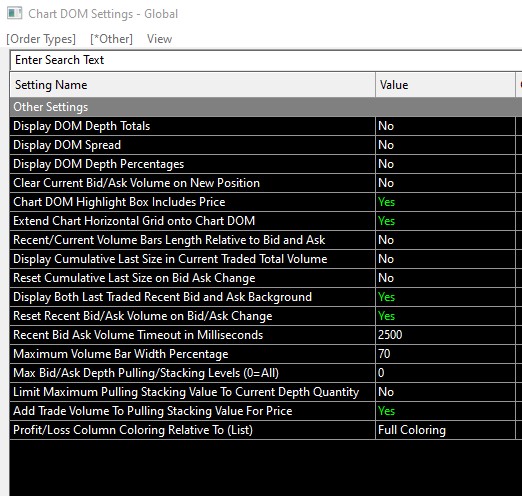

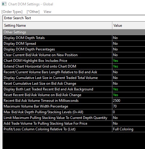

I will attach my setting for you to see if you can duplicate it. I also did a recent sierra charts software update. Not sure if I should go download the old one?
imageScreenshot 2024-02-28 164540.jpg / V - Attached On 2024-02-28 22:46:01 UTC - Size: 92.35 KB - 347 views
