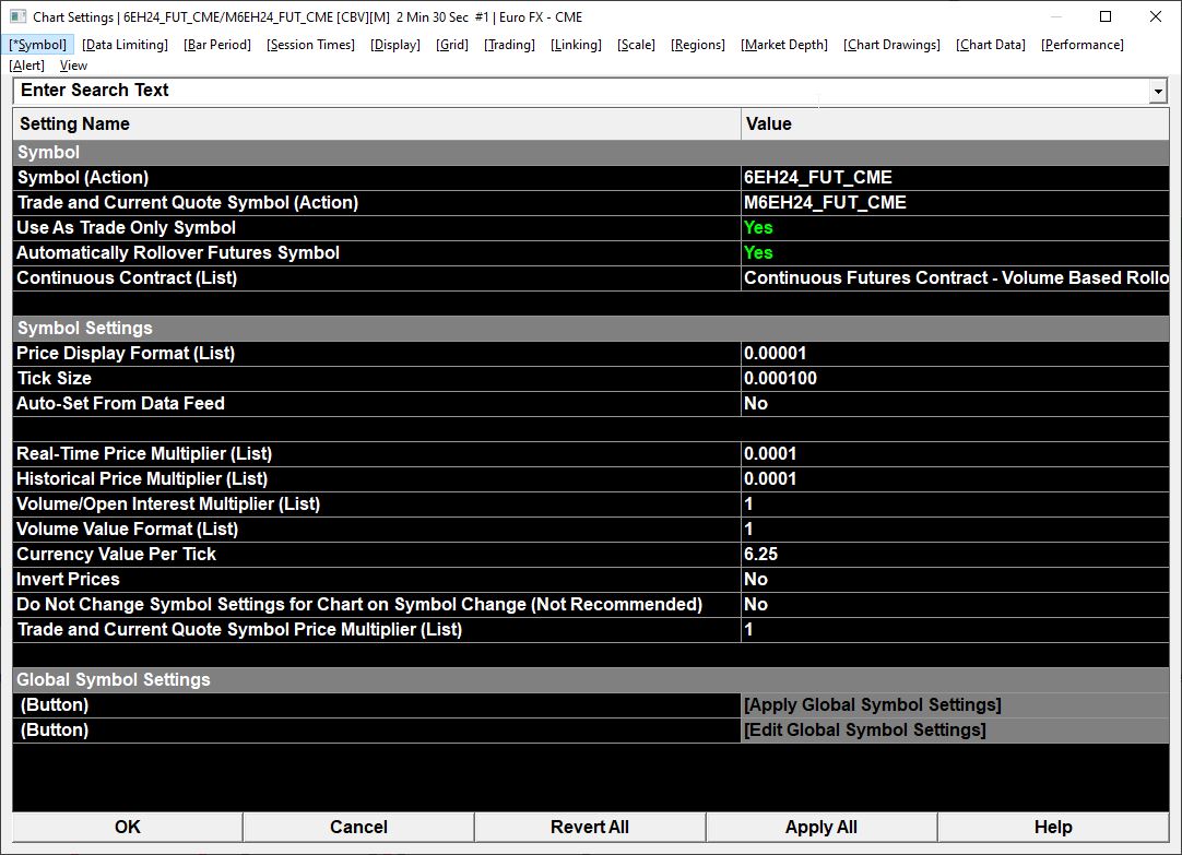

I have a problem with setting up micro contracts for currencies.
I wanted to switch from simulation mode to real account, but for now I have incorrect data in the Trade Activity Log.
I set the symbol 6B on the chart and the trading symbol M6B.

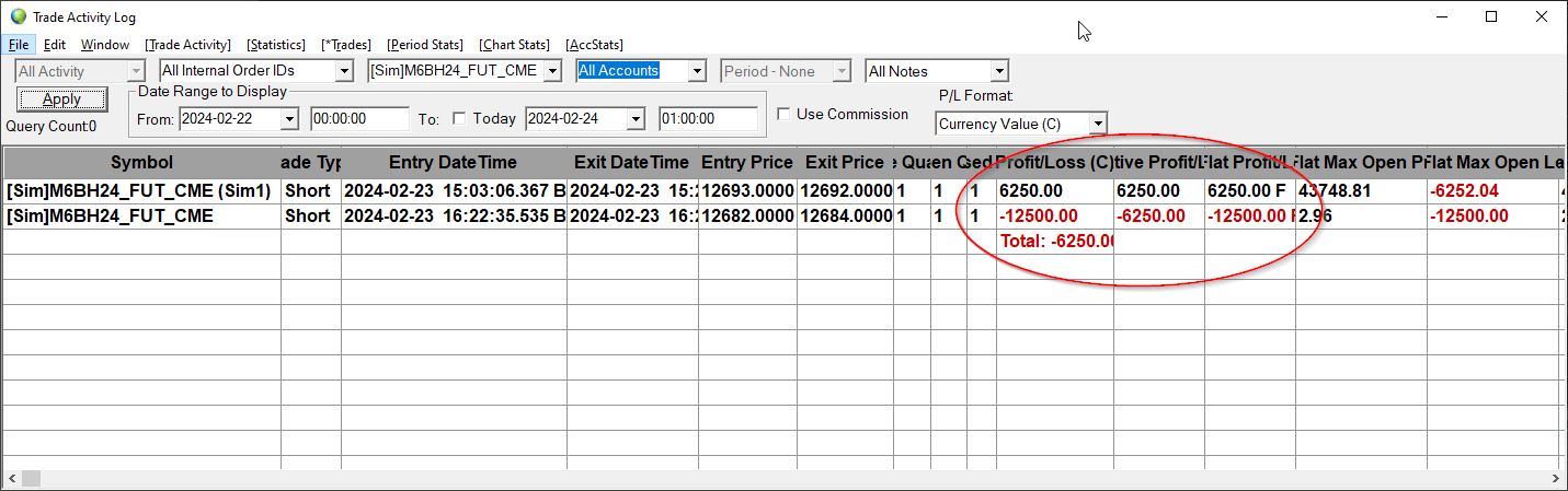

However, the Entry and Exit prices in the Log are incorrect. As a result, P/L is also incorrectly calculated.
The same error occurs on the M6E.
However, for MCL, MGC and MYM the calculations are correct.

image2024-02-27 17_50_04-Clipboard.jpg / V - Attached On 2024-02-27 16:53:55 UTC - Size: 173.99 KB - 178 views
image2024-02-27 17_51_46-Clipboard.jpg / V - Attached On 2024-02-27 16:54:06 UTC - Size: 120.89 KB - 174 views

Sierra Chart Teton Futures Order Routing: Using Trade Symbol

I followed the procedure explained in the link and it doesn't work.
After applying the settings, when I buy or sell, the order is executed, but at the same time the position is automatically closed immediately.
In Trade Activity Log, I see that the entry order is at the correct price (i.e. 1.0845) while the automatic order is still at the wrong price (i.e. 10844).
I also have the opposite example: incorrect entry price and correct exit price.
Both situations occurred with a Buy order.
Should I set anything else?

We notice you have Trade Simulation Mode enabled. There are going to be problems, during a replay or back test using a Trade symbol. During a replay or back test, remove the Trade and Current Quote Symbol from Chart >> Chart Settings.
You will not have problems with live trading.
