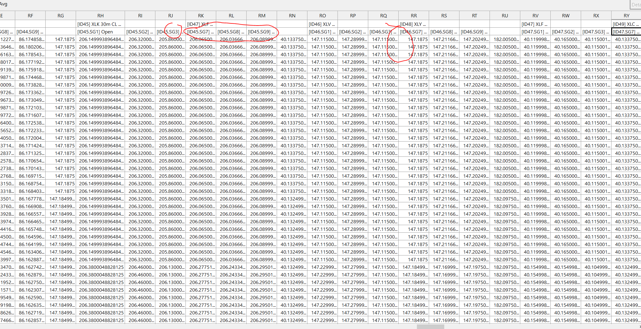

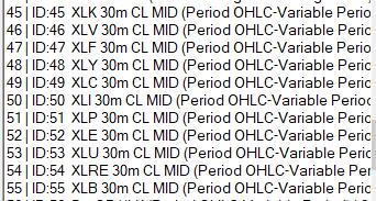

Very bizarre creating spreadsheet study to create a Market Stats to help my trading and as you can see added 30m Period OHLC Variable Period to use in spreadsheet and many of the SG values aren't in spreadsheet.
For Example ID45 for XLK tech sector it only shows SG1, SG2, SG3 doesn't have SG4 the close or SG9 the Midpoint I need. Others like for Financials ID47 its missing SG1-SG6.
I can't figure this out.

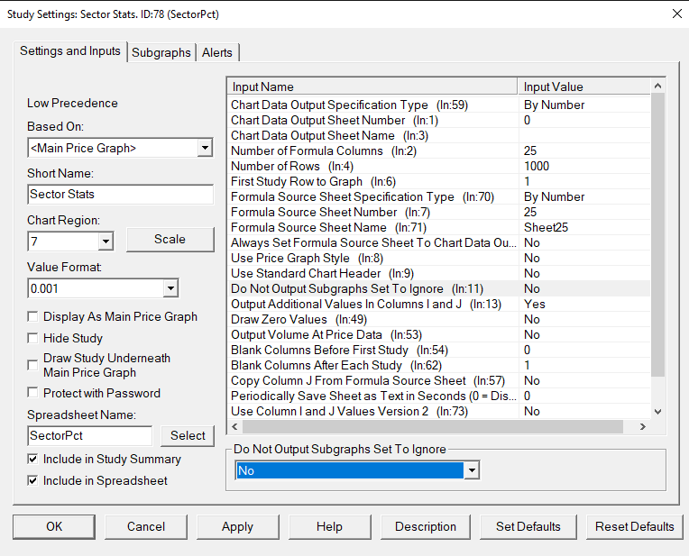

By default, any subgraphs that are set to "Ignore" will show in the Spreadsheet Study, but this can be changed by the following Input for the Spreadsheet Study, which it sounds like you may have set to "Yes":
Spreadsheet Study Inputs: Do Not Output Subgraphs Set To Ignore

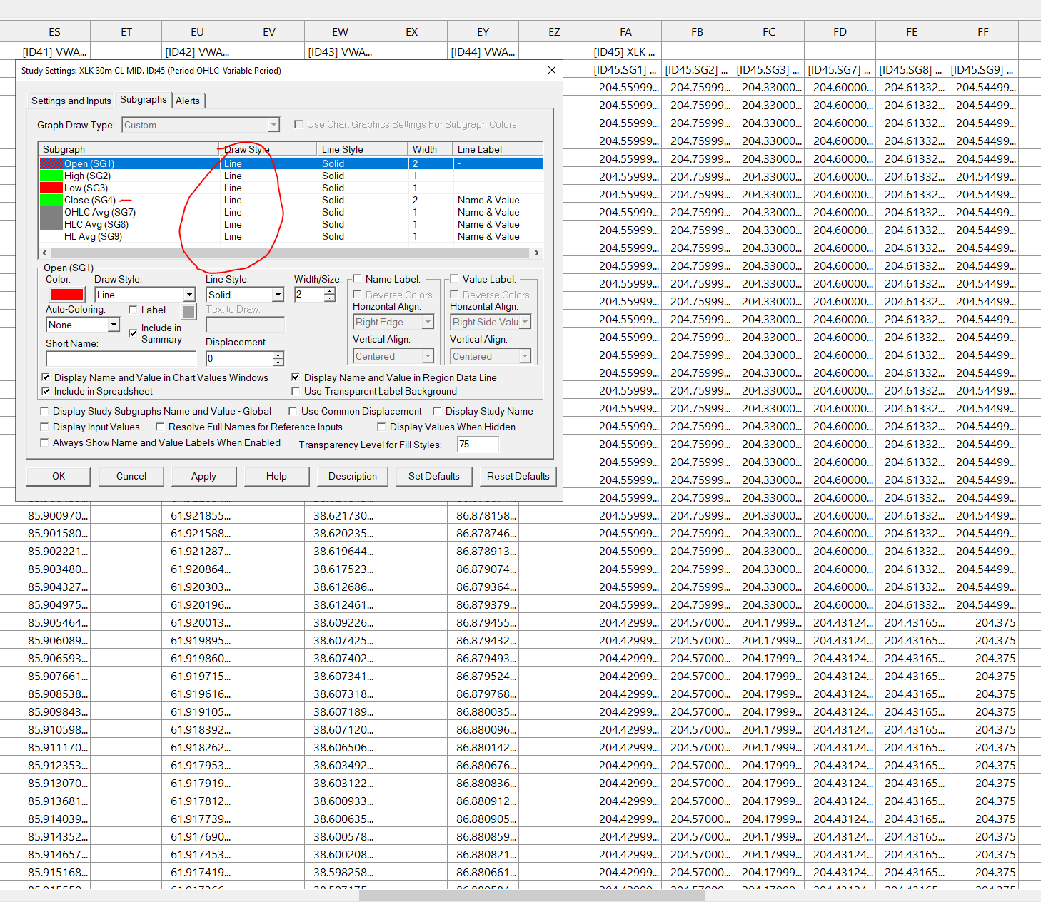

Appreciate the response but I have "Do not output subgraphs set to ignore" to NO and I also am not ignoring that column. I've attached pics to show. As you can see have NO and the column I want the 30m previous close SG4 is set to Dash but its not showing up in spreadsheet. Is there any limit to how many studies and sub graphs can be in there?

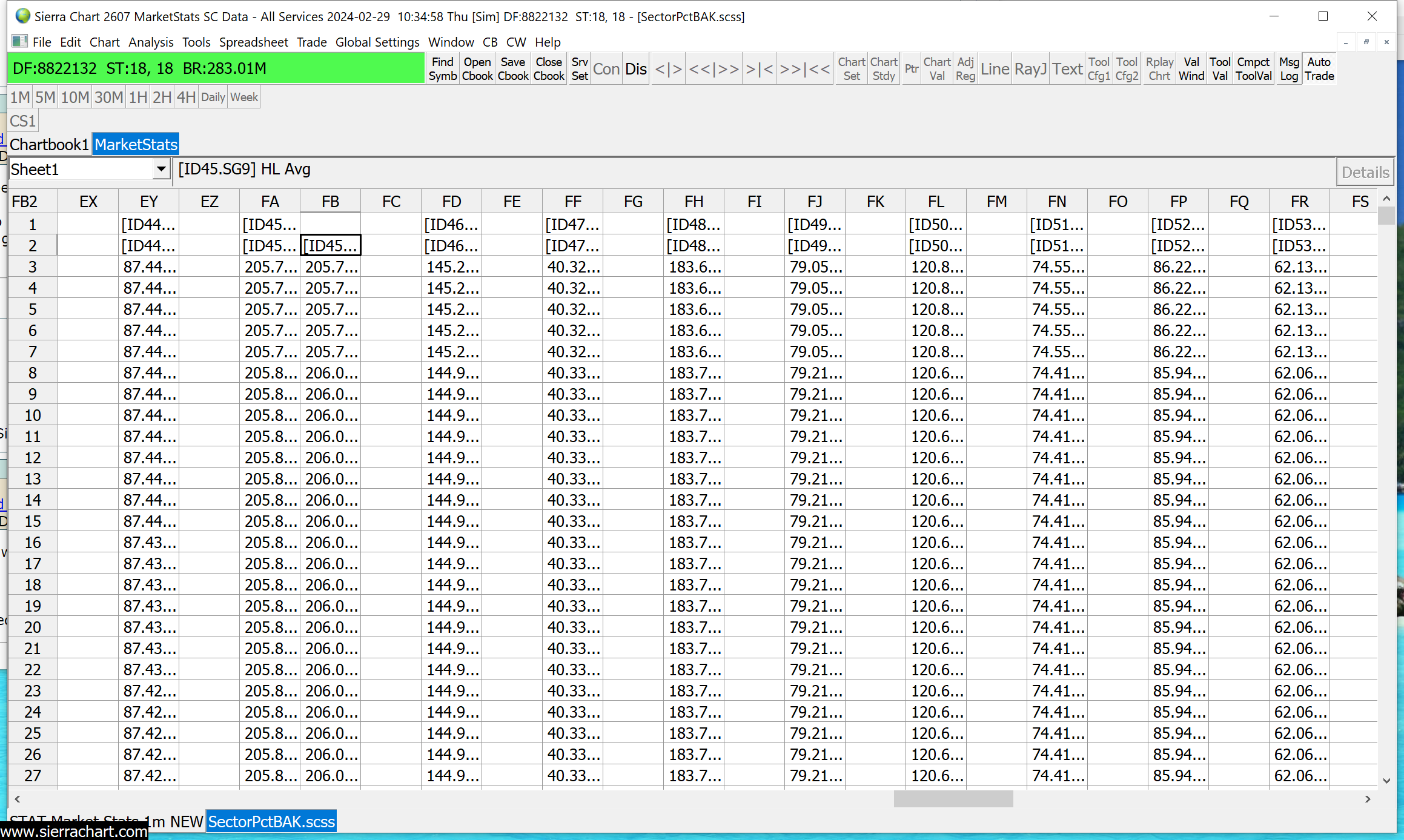

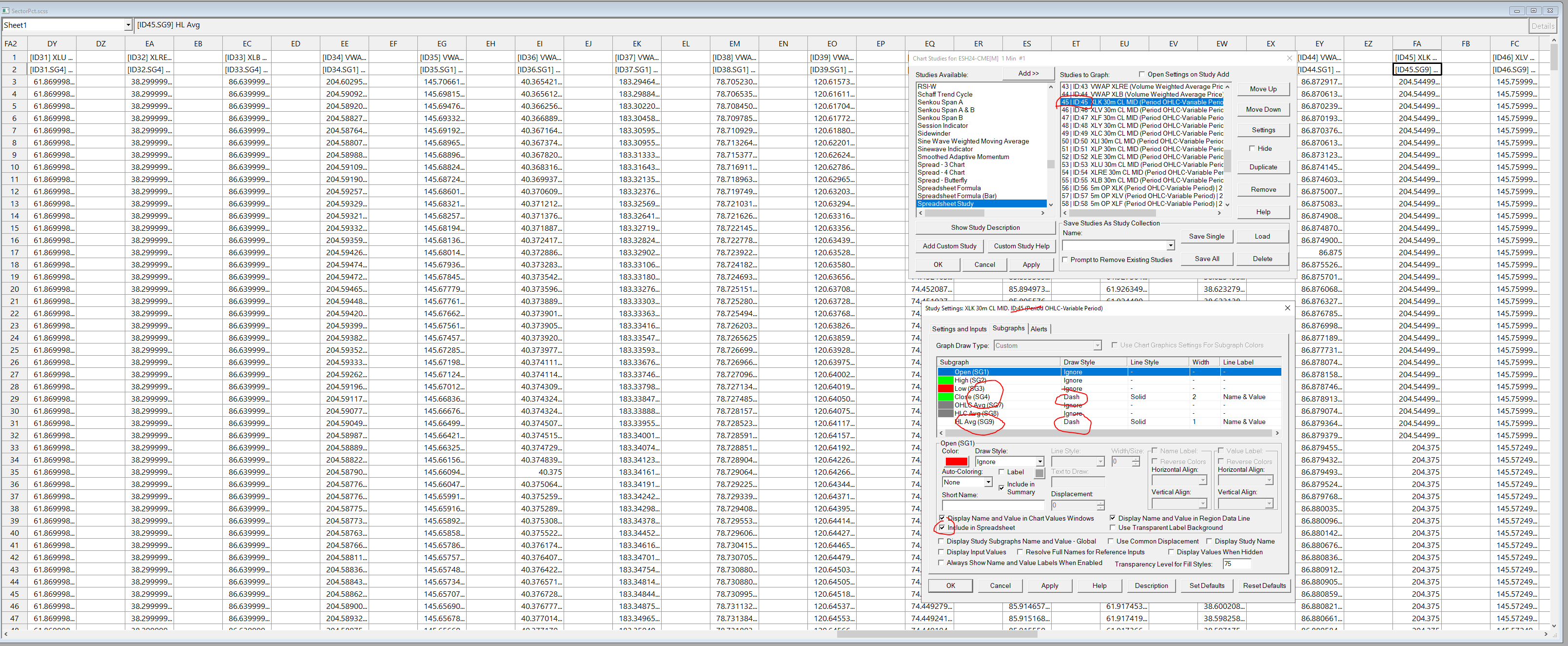

As you can see from this picture Study ID45 has all fields set to Ignore except Close and HL Avg SG4 and SG9 I've included them in spreadsheet but as you can see in row FA it has just the SG9 field not the SG4 Close value. I can see maybe the last spreadsheet got corrupted there were a lot of fields that went away after I turned all the fields I didn't want to Ignore but setting up a brand new spreadsheet study has the exact same problem.

TopGunTrader - Posts: 313
I tried to remove the SG9 HL Avg and it just skipped it nothing was displayed. So I tried to display them all and all are on there except the one I want Close(SG4).
Here's pic.
Can you send me pic showing the values on yours? Maybe I need to upgrade Sierra weird bug fixed but not in my version 2568.
imageCapture2.PNG / V - Attached On 2024-02-29 03:05:40 UTC - Size: 162.5 KB - 229 views

In the chartbook you sent, Study ID45 has only the Close and HL Avg subgraphs set to display and your setting for "Do Not Output Subgraphs Set to Ignore" is to "Yes". And also, you had the "Close" subgraph not set to "Include In Spreadsheet".
When we add the "Include to Spreadsheet" for that item and then clear and recalculate (as per Sawtooth's suggestion) then everything is showing as we expect. Attached is an image showing this for that particular study.
