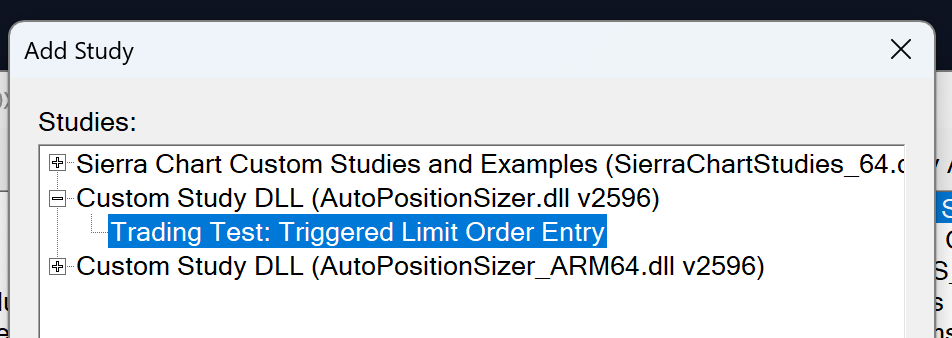

But unable to load/see it in my custom studies (I also tried building locally):
2024-02-23 19:05:51.688 | Found DLL: AutoPositionSizer_ARM64.dll
2024-02-23 19:05:51.693 | AutoPositionSizer_ARM64.dll loading error. Windows error code 193: %1 is not a valid Win32 application.
2024-02-23 19:05:51.693 | InternalVersionNumberToFileNameMap is empty for AutoPositionSizer
2024-02-23 19:05:51.693 | Closest match search for: C:\SierraChart\Data\AutoPositionSizer.dll returned empty result.
My setup:
- M1 Pro
- Windows 11 on Parallels 19 Pro
- Running SierraChart_ARM64.exe, not in safe mode. It says Version 2604 64-bit (this doesn't need to say ARM64?). Not sure if this is relevant, but the dll file says a different version under my study groups (see attached).
When I use SierraChart_64.exe, it builds AutoPositionSizer_64.dll and loads fine. I'm even able to load the study from the _ARM64.dll file in _64.exe. But unable to load either dll file in _ARM64.exe.

imageIncorrect Version in Filename.png / V - Attached On 2024-02-26 20:58:08 UTC - Size: 54.04 KB - 381 views
