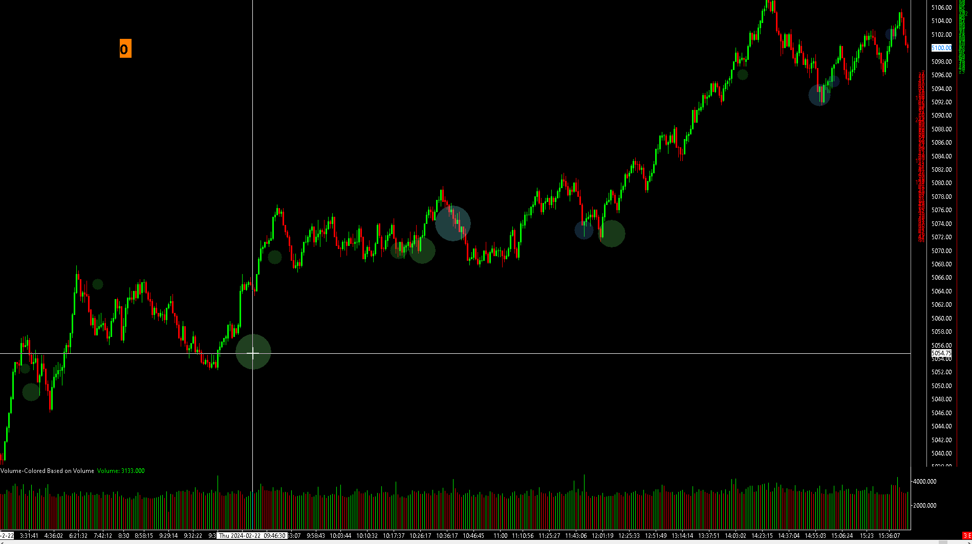

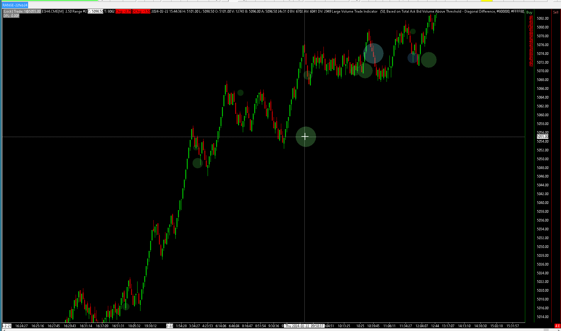

[2024-02-22 23:27:19]
Zorin - Posts: 23
Large Volume Trade Indicator: incorrect horizontal [time scale] positioning on TICK & RANGE charts
Please fix it - er explain me what I am doing wrong.
imagescreen2_2kT.png / V - Attached On 2024-02-22 23:21:33 UTC - Size: 105.72 KB - 236 views
attachmentRANGE-22feb24.Cht - Attached On 2024-02-22 23:23:24 UTC - Size: 33.76 KB - 688 views

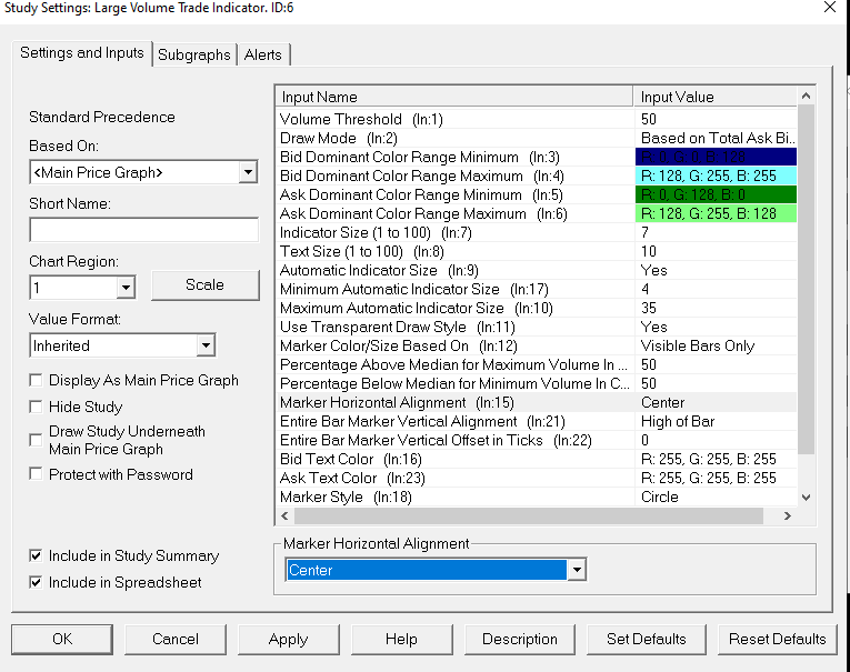

Similar problem with 10R chart
imagescreen1_10R.png / V - Attached On 2024-02-22 23:28:37 UTC - Size: 57.49 KB - 243 views
imageLV_settings.png / V - Attached On 2024-02-22 23:29:01 UTC - Size: 34.49 KB - 233 views

What is occurring is that since you are using one of the "Diagonal" options, you can end up with values for both the Bid and the Ask side. As such, the number are drawn either offset to the left (Bid) or offset to the right (Ask) slightly. The bubbles are also drawn offset and the larger the bubble the further it will be pushed to the side. This is to allow for viewing both sides when it occurs.
If you turn on the display of the numbers, it will be easier to see how it is attached to the candle correctly, again it is just offset to ensure there is room for the display.

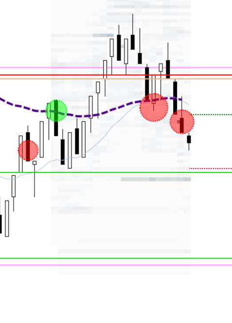

PS just attached the pict what majority of people [incl. myself] would like to see on - more or less
Date Time Of Last Edit: 2024-02-23 17:58:00
imageideal.png / V - Attached On 2024-02-23 17:57:45 UTC - Size: 39.75 KB - 217 views
