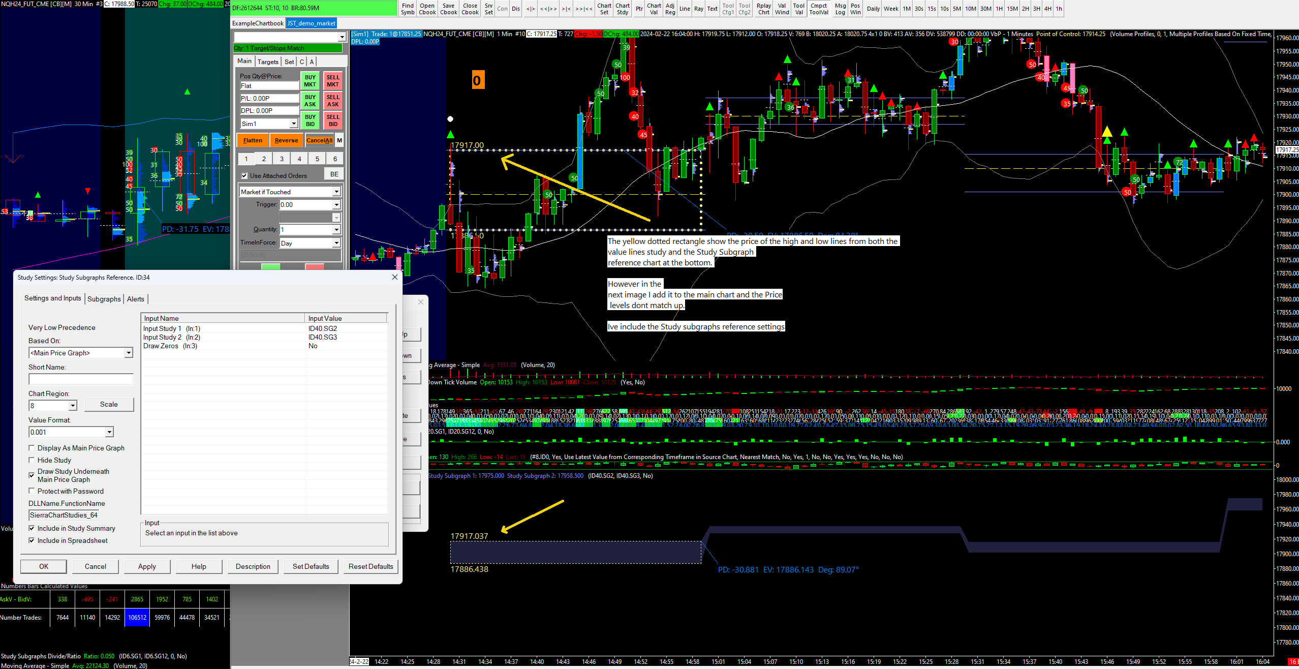

I am currently trying to fill the Volume value area lines using study subgraph reference
I have added a Study subgraph reference and I have set input study 1 and 2 to correspond with the high and low value of the Volume value area lines High and low lines.
the chart region for the Study subgraph reference is 8. when it is set to the this the levels of the high and low of the value area match the Value area lines study high and low correctly.
However when I change the chart region to 1, so it will fill the lines on the Main chart. The Study subgraph reference high and low lines position changes and doesnt match the Value area lines study high and low
What am I doing wrong?. How can I get them to match?

I have solved this issue. I have simply set the Volume value area lines subgraph settings for Vol val area high and low to . Transparent fill top and transparent fill bottom.
