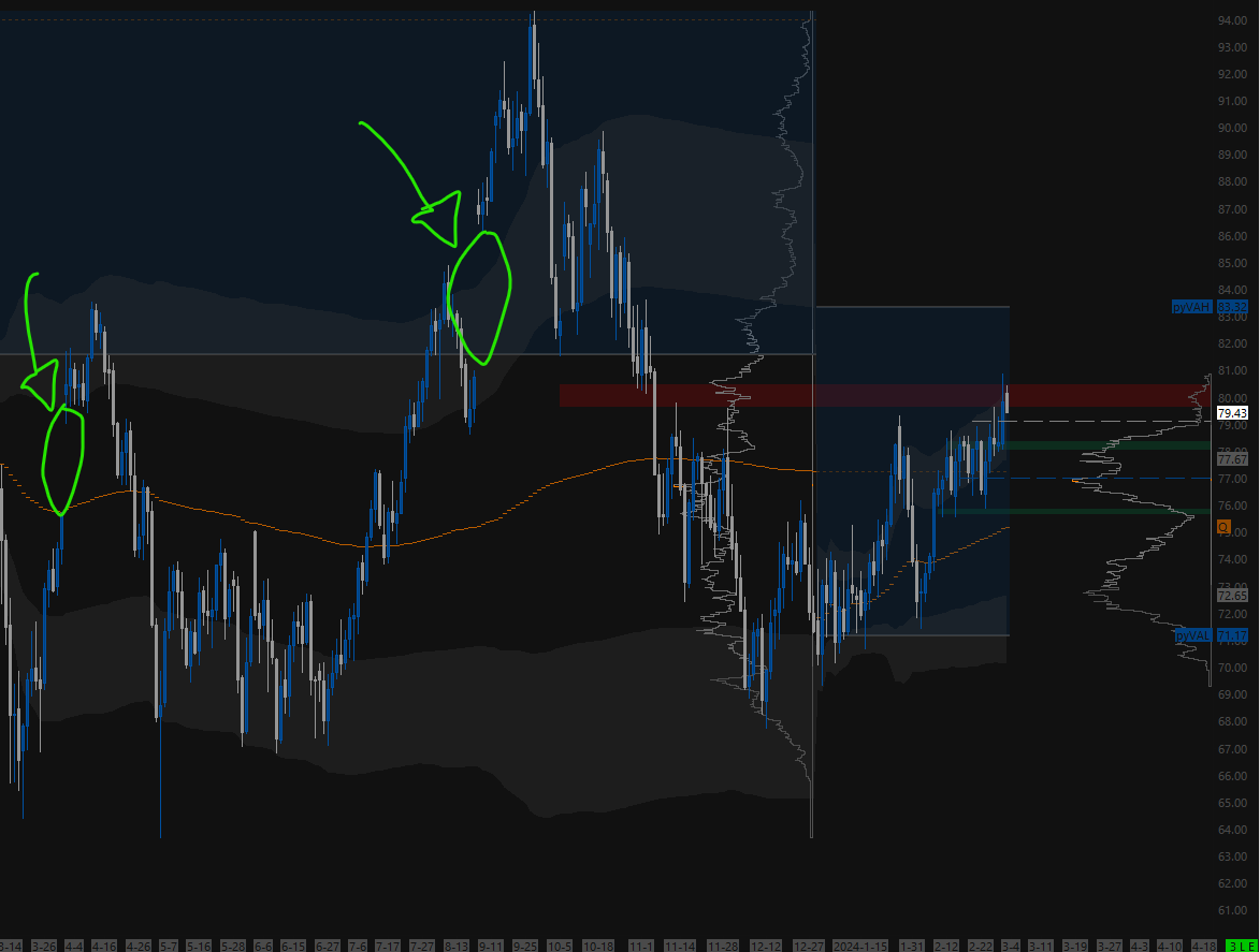

See picture attached. I have a gap in data from 17.08 to 06.09 on instance 2 only. This is CL.
I've tried deleting and downloading from that date and the gap still appears. What else can I do?
Thank you

OriolCasas - Posts: 190
That's strange, I've tried that and I still have the same data gaps.
The first data gap (see picture attached) is in CL from 08-17 to 09-06, when I try to edit/download data the software doesn't let me download from previous dates to 08-17.
Maybe with this info you can help me out a bit more?
Thank you
Tha main instance has no gaps in the data
