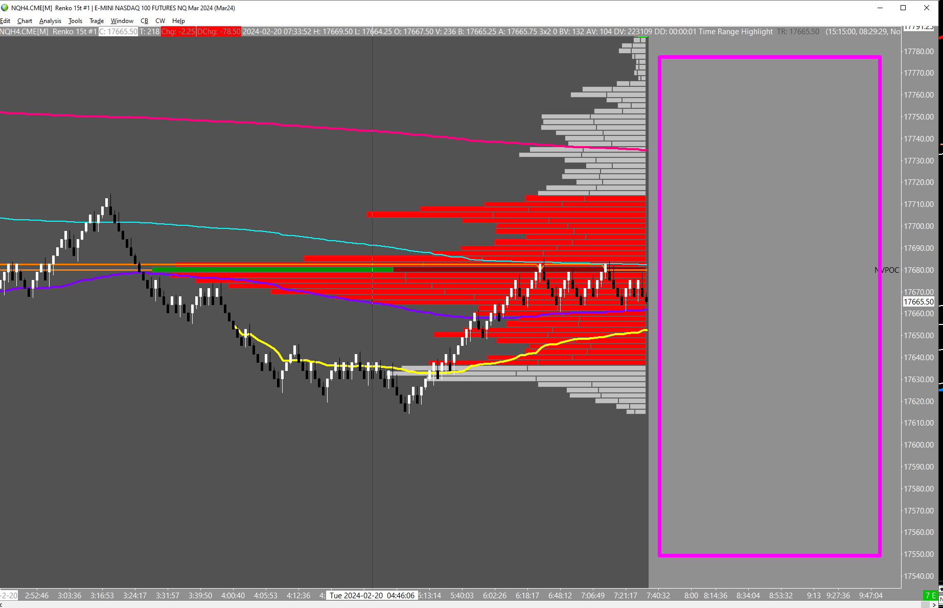

Also while I have you I have searched through the forums but didnt seem to find what I am trying to do. Is there a way to have the volume by price study on the right seperate from the candles so they dont interact at all? I took a screen shot below
imageVP interfeering.png / V - Attached On 2024-02-20 21:12:40 UTC - Size: 82.77 KB - 204 views
[2024-02-20 21:41:16]
To do what you are wanting, you first would need to setup the Volume by Price profile and have it right-aligned and aligned to the far right. Refer to the following for an example:
Volume By Price Study: One Volume Profile at End for Day Session
Then you would need to use the "Lock Fill Space" option to define where you want the bars to stop showing in your chart. Refer to the following:
Chart Menu: Lock Fill Space (Chart menu)

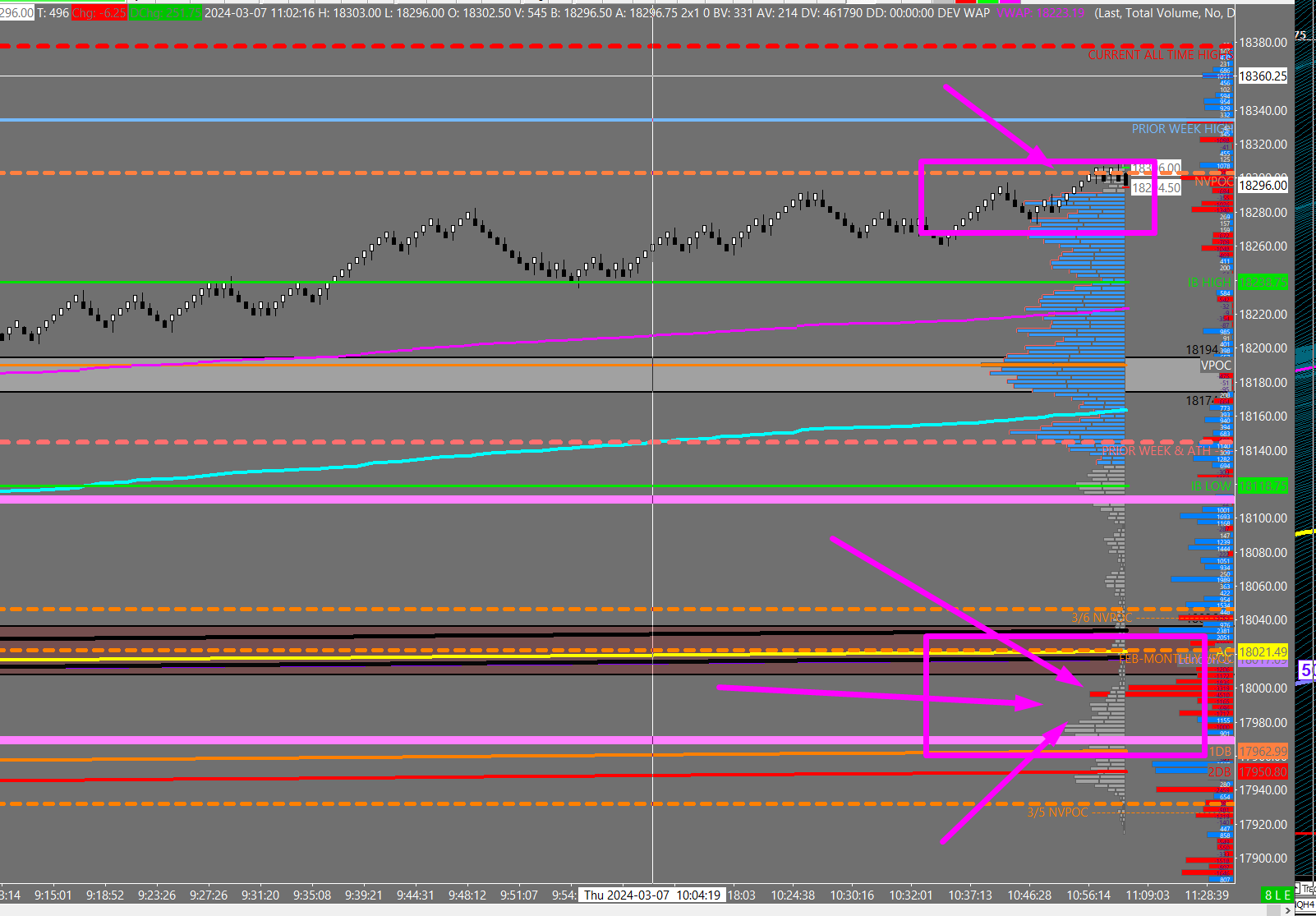

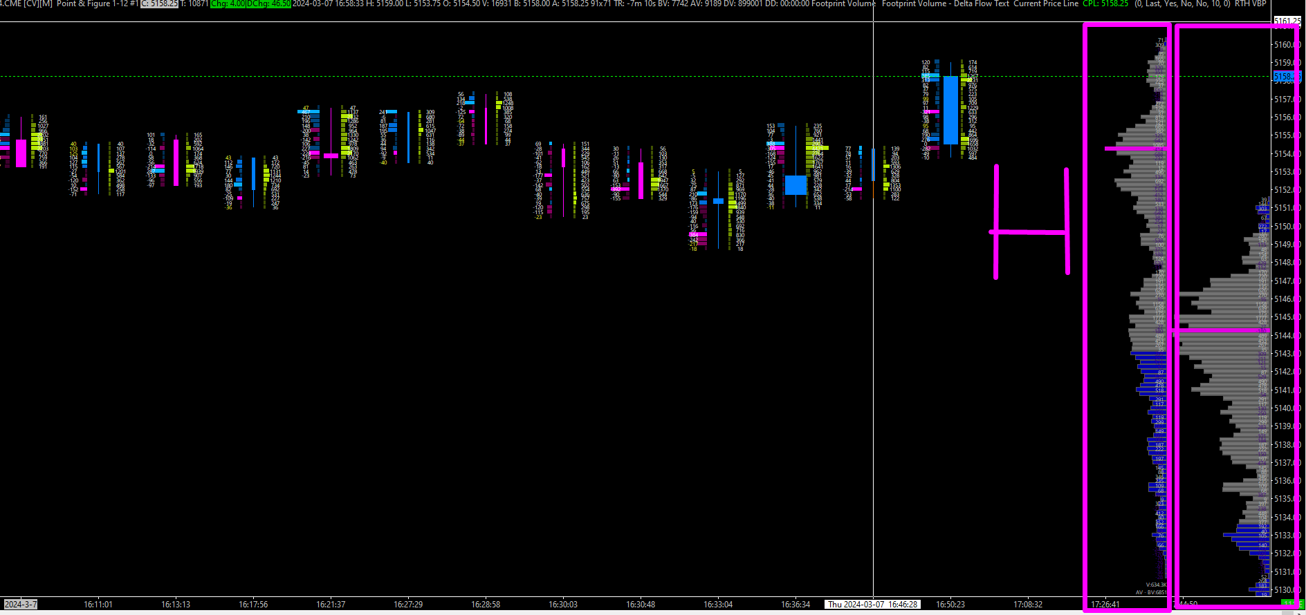

Okay how do I do this twice? Ive read all the lock fill space multiple right aligned profiles and cannot seem to find the answer. So I have 1 volume by price and showing delta and the other a normal volume profile. I want them both locked in place without overlapping eachother and price not able to cross over into their lanes. I actually have done it in the past somehow but I cannot seem to replicate it. The black background picture is the one thats correct I made years ago and the grey background is the one I have recently made and cant figure it out.
imageDuo profile example 1.png / V - Attached On 2024-03-07 17:02:56 UTC - Size: 116.34 KB - 200 views
imageOverlap 1.png / V - Attached On 2024-03-07 17:02:59 UTC - Size: 116.8 KB - 266 views
[2024-03-07 17:50:35]
Set both profiles to have the Input for "Align to Far Right" to "Yes". Refer to the following:
Volume By Price Study: Align to Far Right
And you also need to have the Input for "Allow Side by Side Profiles on Right Side" set to "Yes". Refer to the following:
Volume By Price Study: Allow Side-By-Side Profiles on Right Side
You may want to play with the "Volume Bar Width Type" and "Volume Bar Width Percentage" inputs to get the sizes as you want them. Refer to the following and the item below it:
Volume By Price Study: Maximum Volume Bar Width Type
And finally, to keep the bars from overlapping the profiles, you need to use the "Lock Fill Space" option. Refer to the following:
