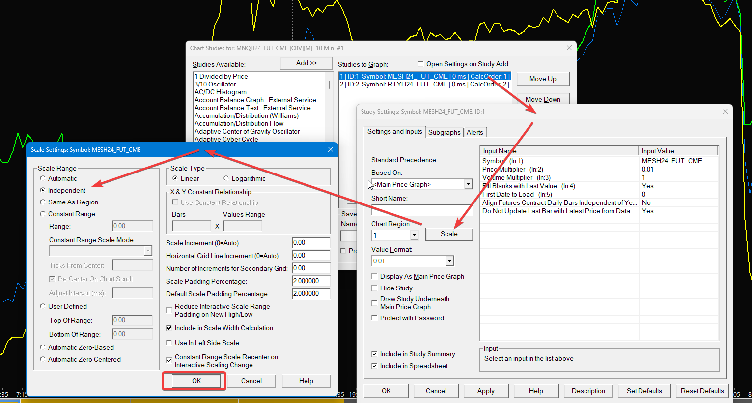

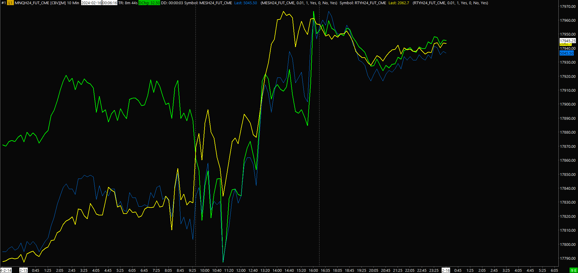

Anyhow, I followed the instructions by Verrillio trading and successfully did set up the chart as described.
MNQ main chart with automatic scale
added to studies "Add additional Symbol"
The study does allow you to set them to chart region 1.
1st one for MES,
2nd one for RTY
On both I set the scale to independent, and the price multiplier to 0.01.
and the result is the expected overlay of the 3 symbols
I'm on version 2597
Tried the same also with "Overlay Bar" providing the exact same result.
I don't think any feature was deleted, just something missing in your setup of the chart.
What is the result you see on your end?
Keep in mind that the "Add additional Symbol" study is limited to the contract time.
Meaning when you look at the H contract you will only see data starting mid December.
imageMNQH24_FUT_CME [CBV][M] 10 Min #1 2024-02-16 00_06_25.536.png / V - Attached On 2024-02-16 05:06:44 UTC - Size: 44.41 KB - 323 views

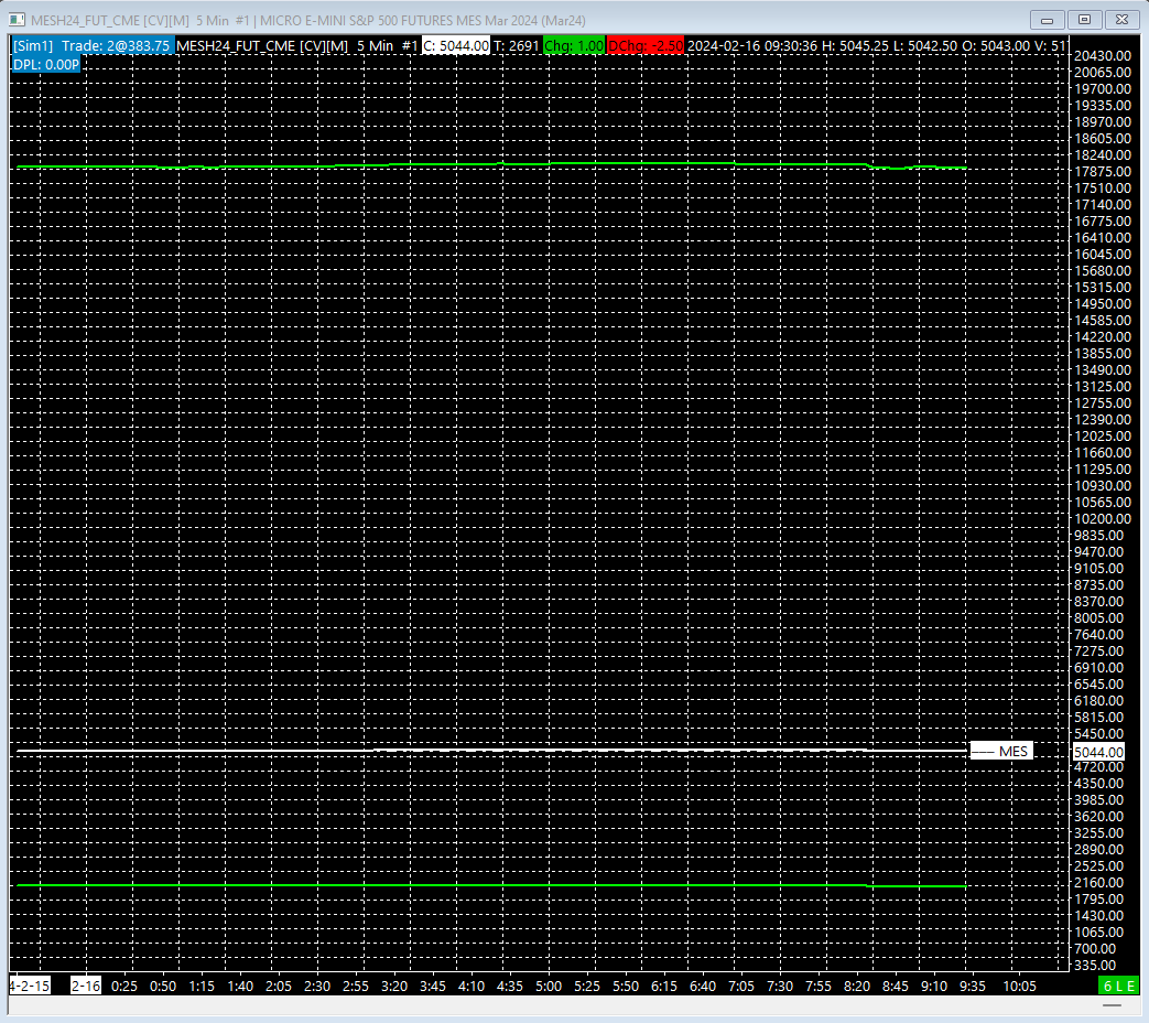

I' using version 42233. I always update SC. It's working for you because you have an older version. I agree that something was removed because my charts were created on an older version and it still worked until the chart was lost. When I use it in the current version it places the symbols on the chart but without the price adjusted graphs, NQ is at 17900, RTY is at 2040 and MES is at 5050.
imagemes chart.png / V - Attached On 2024-02-16 14:39:05 UTC - Size: 63.72 KB - 206 views

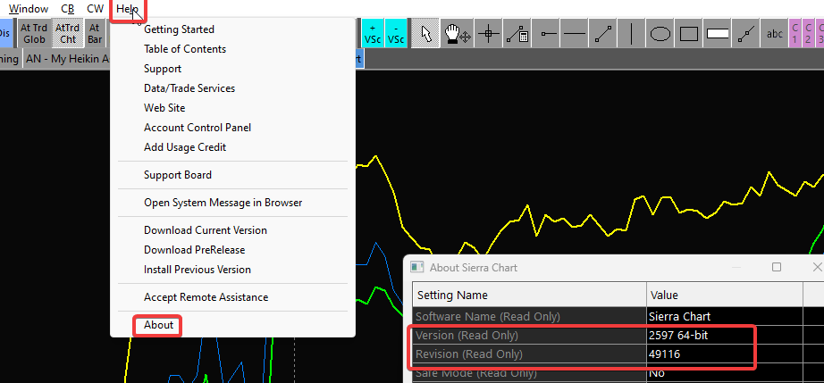

42233 is the revision number, what is your version number.
On the help >> about page one row above (see attached screen shot).
I'm on version 2597 and revision 49116
You screen shot looks like the scale for the studies is not set to "Independent".
When I change the scale for the studies to Automatic, I get the same as you have.
To change the scale for the studies, got to Analysis >> Studies or F6
Double click your "Add Additional Symbol" for NQ
In there click the Scale button and activate "Independent".
Do the same for RTY.
Is there a reason you do not update to the latest SC?
imageSierraChart_64_T2L99JukAD.png / V - Attached On 2024-02-16 15:48:46 UTC - Size: 123.53 KB - 259 views
imageSC Version and Rev.png / V - Attached On 2024-02-16 15:52:49 UTC - Size: 29.92 KB - 225 views
