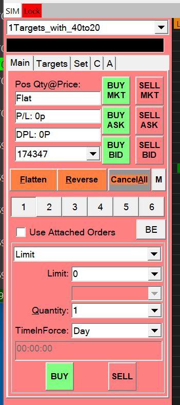

There is something about your order setup that CQG does not like. Most likely this is the "Time in Force". Be sure to check this with both the parent and any attached orders. It is best to have this set to "Day" (assuming you are not holding any overnight positions) or "Good til Cancelled".
But you would need to check with your broker to get the specific issue.

still have the same problem:
2024-02-14 18:46:42.215 | Trade Order Error - CQG order update. Status: REJECTED. Text: Order request rejected. Please contact customer support.[Order parameters are invalid]. Internal Order ID: 3635. Service Order ID: 5246635. Symbol: F.US.DDH24. Account: 174347
2024-02-14 18:47:37.852 | Trade Order Error - CQG order update. Status: REJECTED. Text: Order request rejected. Please contact customer support.[Order parameters are invalid]. Internal Order ID: 3638. Service Order ID: 5049938. Symbol: F.US.DDH24. Account: 174347
2024-02-14 18:47:58.077 | Trade Order Error - CQG order update. Status: REJECTED. Text: Order request rejected. Please contact customer support.[Order parameters are invalid]. Internal Order ID: 3639. Service Order ID: 5290375. Symbol: F.US.DDH24. Account: 174347
https://www.sierrachart.com/Attach.php?Form=Form4b8ca7971cc0363b58f28256512bc118&To=SupportBoard&ForumID=0
imageScreenshot 2024-02-14 184834.png / V - Attached On 2024-02-14 17:54:22 UTC - Size: 30.15 KB - 219 views
