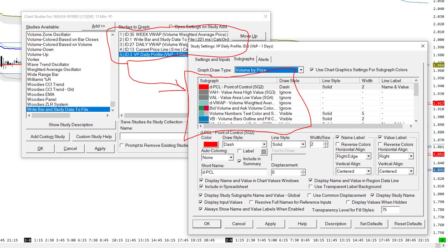

I would like to customize indicators/fields in export for write bar study. I see there all the studies in subgraphs, but I don´t know how to customize then.
I need to remove some of them and others I need to export. How to do that please?
thanks

I´m not sure if we are talking about the same thing, I want to customize only existing fields within the study.
This means I want to export with write bar study only some of the fields available in subgraph list.
For better clarification I have attached one screen from Sierra.
So, it is possible to customize export fields in study?
imageSnímka.JPG / V - Attached On 2024-02-11 09:52:03 UTC - Size: 227.38 KB - 210 views

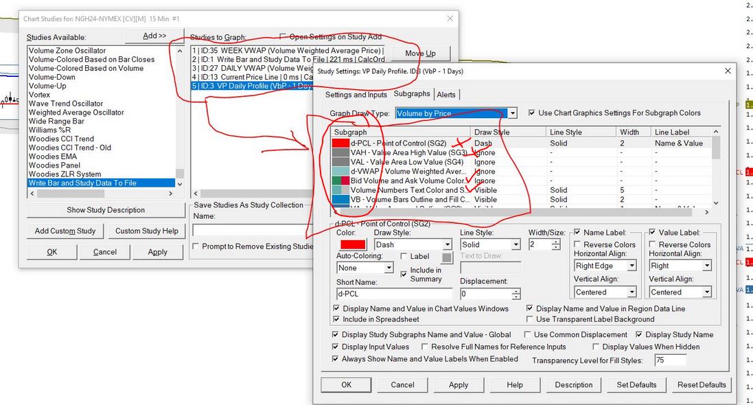

stefkovic.m28 - Posts: 45
I think, that is not again what I am talking about, please see my attached screen, where I have marked the positions with red, which I want to display/export in study and the others, that I do not want to export.
So I am looking for the option, where can I change the positions and manage export fields.
Is there this option?
thanks
imageSnímka.JPG / V - Attached On 2024-02-13 09:36:32 UTC - Size: 135.43 KB - 228 views
[2024-02-13 17:09:24]
You are correct, we are not fully understanding what you are wanting. But we have given you all the information on what can be done in our prior posts. Therefore, if the answer is not there, then the only remaining option is that you need to create a custom study.
