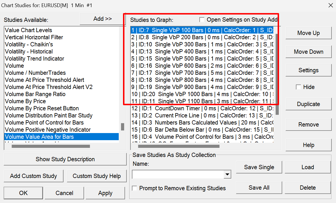

Is there a way to add multiple bar count on increamnet (one profile on 100 bar count,one profile on 200 bar count and so on). I want 10 profiles on 100 increament. (I had to add 10 separate profiles. Is it possible to add in 1)?

Short answer: I don't think so. Volume by Price seems to be a quite heavy function, which receives quite some special treatment by the platform. e.g. the ability to manually draw VbP areas and functions to manage those, but still adding them to the Study list. Just looking at the amount of Inputs and Subgraphs, there is a lot going on. I do some ACSIL scripting but I'm by far no pro doing so. While I think an ACSIL sript as you describe it could be made, it will not be a simple task to do so. A first glance at the SC functions list ACSIL Interface Members - Functions there is no Volume by Price function to be found. But why would you need it anyway? The way you did it is totally legit. Actually it is the great strength of SC allowing you to add many studies and link them. Just build your setup as you like it and save it as a Study Collection. The collection will remember your settings. When you activate the "Prompt to Remove Existing Studies" checkbox, SC will prompt about removing existing studies. If you select then no it will add all what is in the collection to your current chart studies. Another way to have those a |

YEAH, that's why I messaged the support. I am getting lagging issues. The chart moves so laggy. What should I do to make current setup? I want to put 20 POC's of different bar counts (100, 200,300,400,... 2000).

The answer to the initial question is there is not a way to setup a single Volume by Price profile for what you are wanting. You can setup a single one for every 100 bars, but not starting at 100, then 200, then 300, etc.

| User719512 - Posts: 477 |
User285179, I'm still confused by this post as your very first post has a solution to the problem: adding ten studies, one for each lookback you want. It would take custom code to do this in one study and it's unclear of what, if any, advantage that would have. Maybe it could have a slight performance benefit as it would be highly specialized. |
