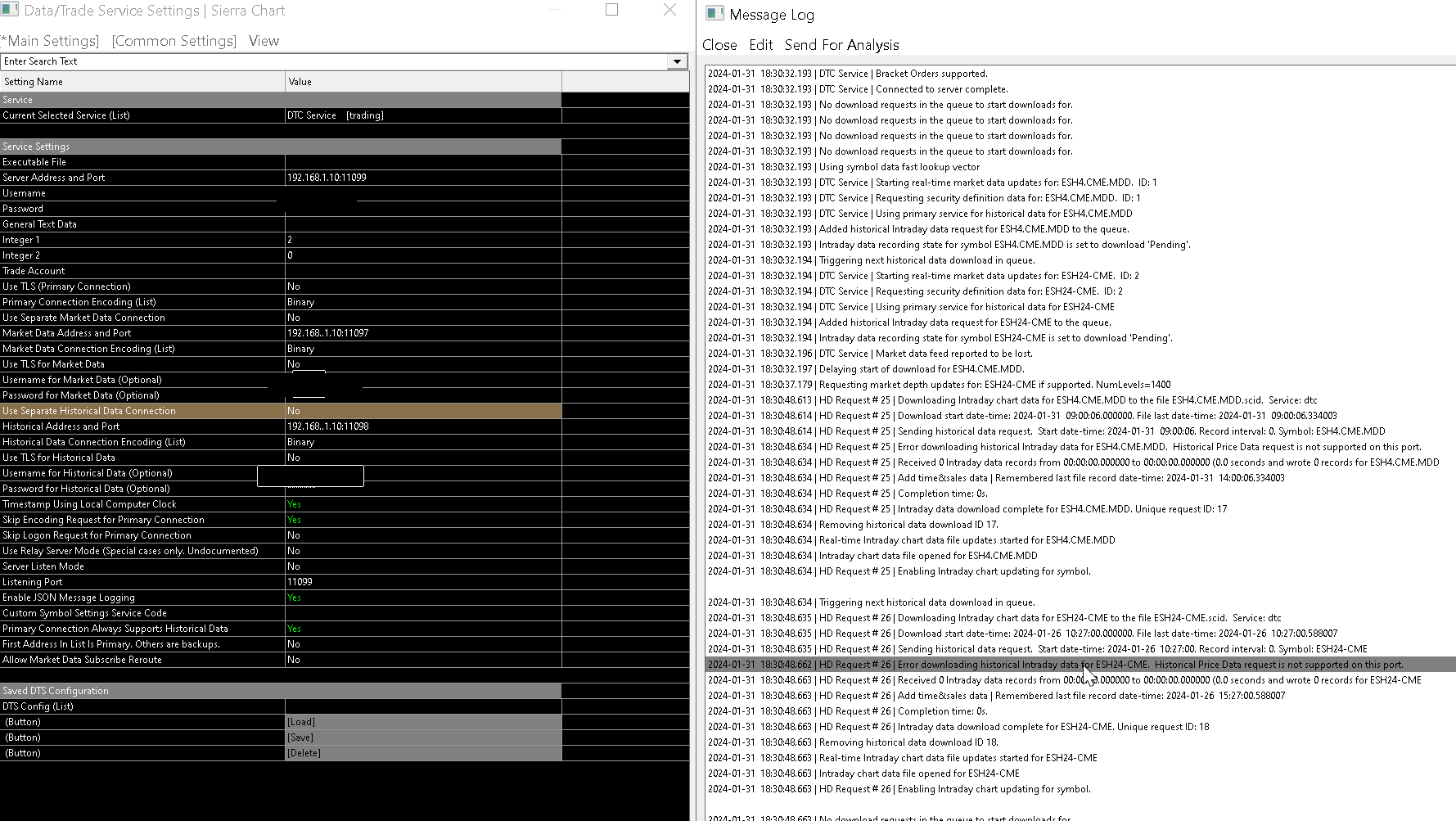

I have TWO Sierra chart instances: 192.168.1.10 [server] and 192.168.1.11 [client]
I'm trying to use Sierra's DTC server, but cannot download historical data; server always shows 0 historical data clients connected
(NOTE: I CAN connect to the server using EXE file from this thread : DTC client example although it cannnot download anything - server shows me that ONE [1] historical client IS connected - when I'm connected to 192.168.1.10:11098 using this EXE file]

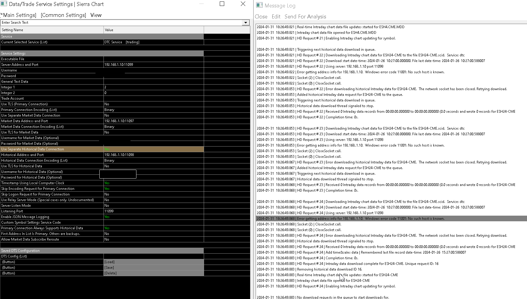

On the client side:
when I set "use separate historical data connection" to NO, client LOG tells me that "Historical Price Data request is not supported on this port"
when I set "use separate historical data connection" to YES, client LOG tells me that "no such host is known"
Looking for "no such host is known" gives me a DNS-related error[s], bit it's not the case - I'm using IP addresses [unless your code still treating 192.168.1.10 as a HOSTNAME ??]

Attached server settings & client settings
What I am doing wrong?

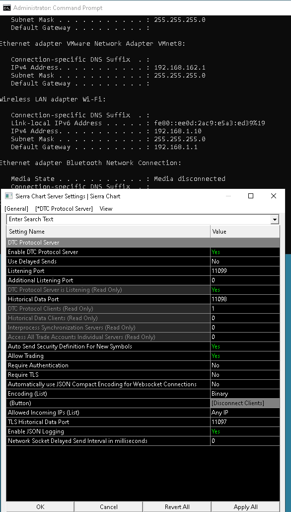

P.S. it does NOT look like DNS / connectivity problem; I can see the "login" prompt - for a second or two - using PuTTY & RLogin from the server [it kicks me out shortly, but it's enough to see that server actually responds with the prompt on both ports - the DTC main one and Historical Data ]

imageclientA=NoSuchHostKnown_when_SeparateHistDataConn_ON.png / V - Attached On 2024-01-31 23:54:56 UTC - Size: 100.56 KB - 152 views
imageclientB=HistoricalPriceData_Not_Supported_on_This_Port_when_.png / V - Attached On 2024-01-31 23:56:46 UTC - Size: 108.39 KB - 143 views

Based upon the configuration of the DTC Protocol Server in your installation of Sierra Chart, historical data has to be downloaded on port 11098.
So this does make sense:
However, you cannot access data from some exchanges like the CME:
Data and Trading Communications (DTC) Protocol Server: Restrictions
You are getting this because you are using an invalid IP address that contains 2 dots side-by-side:
