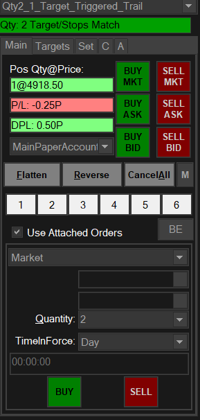

Make sure the parent order quantity is set to 2:
Basic Trading and the Trade Window: Main >> Order Quantity (Quantity)
[2024-01-29 16:20:46]
User666015 - Posts: 66
Parent order quantity is set to 2, makes no difference I'm afraid (screenshot attached).

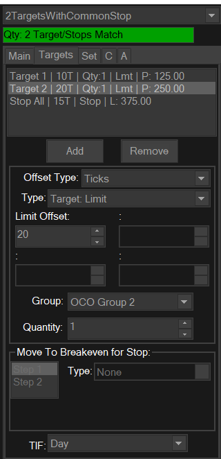

We would need to see the Targets tab of your Trade Window to see how you have things setup in there. It should look like the following (ignoring the Move to Breakeven for the Stop):
Attached Orders: 2 Targets and Common Stop with Move to Breakeven on First Target
[2024-01-29 18:57:52]
Thanks John,
I actually followed this guide so all is correct, I even downloaded the twconfig file and applied it still with no luck, it's really strange!
Please see attached pic.
Cheers,
Bill
image2024-01-29 18_56_04-ESH24 [CV][M] 5 Min #5 _ E-MINI S&P 50.png / V - Attached On 2024-01-29 18:57:41 UTC - Size: 22.47 KB - 202 views
