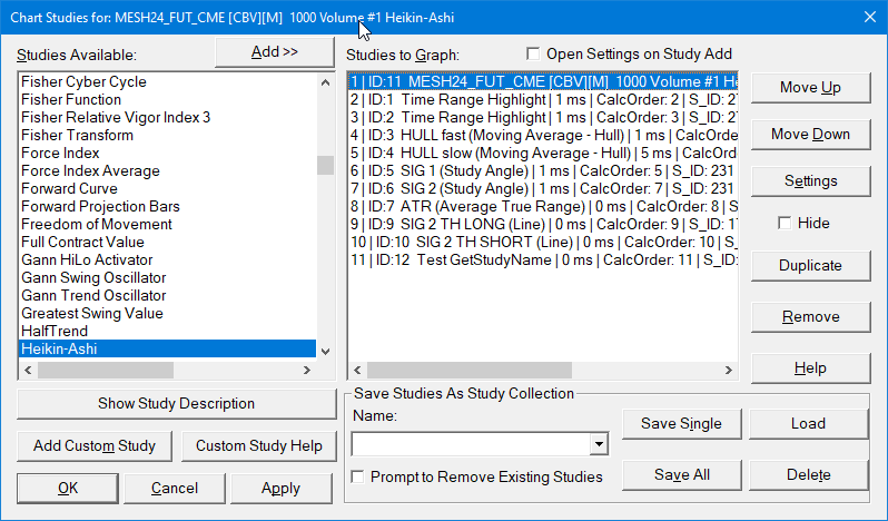

The attached screen shot shows the studies I've on my chart,

i=0
GetStudyName=MESH24_FUT_CME [CBV][M] 1000 Volume #1
GetStudyNameFromChart=MESH24_FUT_CME [CBV][M] 1000 Volume #1
GetStudyNameUsingID=MESH24_FUT_CME [CBV][M] 1000 Volume #1
GetStudyInternalIdentifier=MESH24_FUT_CME [CBV][M] 1000 Volume #1
i=1
GetStudyName=MESH24_FUT_CME [CBV][M] 1000 Volume #1 Heikin-Ashi
GetStudyNameFromChart=Time Range Highlight
GetStudyNameUsingID=Time Range Highlight
GetStudyInternalIdentifier=Time Range Highlight
i=2
GetStudyName=Time Range Highlight
i=3
GetStudyNameFromChart=HULL fast
GetStudyNameUsingID=HULL fast
GetStudyInternalIdentifier=HULL fast
i=4
GetStudyName=HULL fast
GetStudyNameFromChart=HULL slow
GetStudyNameUsingID=HULL slow
GetStudyInternalIdentifier=HULL slow
i=5
GetStudyName=HULL slow
GetStudyNameFromChart=SIG 1
GetStudyNameUsingID=SIG 1
GetStudyInternalIdentifier=SIG 1
i=6
GetStudyName=SIG 1
GetStudyNameFromChart=SIG 2
GetStudyNameUsingID=SIG 2
GetStudyInternalIdentifier=SIG 2
i=7
GetStudyName=SIG 2
GetStudyNameFromChart=ATR
GetStudyNameUsingID=ATR
GetStudyInternalIdentifier=ATR
i=8
GetStudyName=ATR
i=9
GetStudyName=SIG 2 TH LONG
GetStudyNameFromChart=SIG 2 TH LONG
GetStudyNameUsingID=SIG 2 TH LONG
GetStudyInternalIdentifier=SIG 2 TH LONG
i=10
GetStudyName=SIG 2 TH SHORT
GetStudyNameFromChart=SIG 2 TH SHORT
GetStudyNameUsingID=SIG 2 TH SHORT
GetStudyInternalIdentifier=SIG 2 TH SHORT
i=11
GetStudyName=Test GetStudyName
GetStudyNameFromChart=MESH24_FUT_CME [CBV][M] 1000 Volume #1 Heikin-Ashi
GetStudyNameUsingID=MESH24_FUT_CME [CBV][M] 1000 Volume #1 Heikin-Ashi
GetStudyInternalIdentifier=MESH24_FUT_CME [CBV][M] 1000 Volume #1 Heikin-Ashi
i=12
GetStudyName=
GetStudyNameFromChart=Test GetStudyName
GetStudyNameUsingID=Test GetStudyName
GetStudyInternalIdentifier=Test GetStudyName
