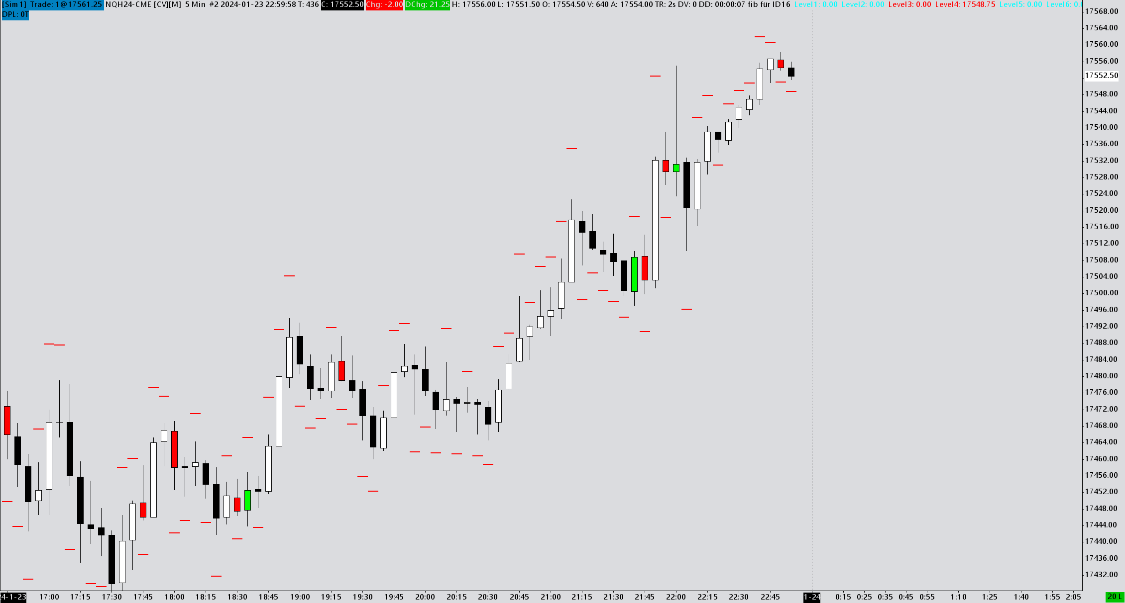

I have highlighted candles with the "Color Bar Based on Alert Condition" study. Now I would like to apply the "Auto Retracement/Projection" study to these candles only. To do this, I copied the alert condition from "Color Bar Based on Alert Condition" into the "Auto Retracement/Projection" study. Unfortunately, it does not work. The desired Fibonacci level is applied to all candles in the chart. However, they should only be applied to the colored ones.
Here is a screenshot.
How can I solve this?
Thank you very much.
https://www.sierrachart.com/image.php?Image=1706049938887.png
imageScreenshot_1.png / V - Attached On 2024-01-23 22:38:06 UTC - Size: 15.39 KB - 305 views
[2024-01-24 15:39:28]
What you are wanting to do is not really possible. You can base the "Auto Retracement/Projection" on a different study as outlined here:
Auto Retracement/Projection: Basing Auto Retracement/Projection on Another Study
But the problem occurs since you are only wanting to use some bars, and not all of them. This will create zeros where the bars that are not being used were which throws off the auto-retracement/projection.

[2024-01-29 16:45:51]
The issue is that you can not use the "Auto Retracement/Projection" due to the zero values. You would have to program a retracement/projection tool, so you would most likely have to do this using ACSIL.
