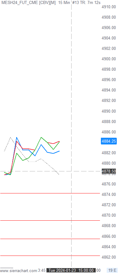

I'm using "Study price overlay" with "line on close" to compare few symbols on one chart. I have set each study scale to "Independent", when I move chart to the left or right, symbol lines are expanding and contracting - that is unusable, because it gives different view.
I have tried different scale ranges for chart but it didn't work.
Is there any solution to stop symbol lines expanding and contracting?

Example (not as bad as usual, notice red and green lines, also dotted line is completely shifted):
https://www.sierrachart.com/image.php?Image=1706038669253.png
https://www.sierrachart.com/image.php?Image=1706038703944.png

Since you are using an "Independent" scaling, things will shift about. This is the whole point of that scaling option.
It sounds like you really want to have the data tied together at some point. We recommend using the Spreadsheet Study to take the data and adjust the values so they are all within the same range by adjusting the data for the other symbols to match the main symbol at some point in time. Then you would use the scaling option of "Same as Region" and the lines will all move together.
