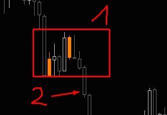

[2024-01-23 01:32:52]
User117548 - Posts: 28
I want to highlight the color of all bars if there is C > L (Insidebar candles).
1st position, all candles in the crossword updated in the attached photo.
Until there is C< L (insidebar)
Location attached to image number 2.
image8d9dfa50-c496-4f23-9729-73cfc3fc60bb.jpg / V - Attached On 2024-01-23 01:32:31 UTC - Size: 9.07 KB - 258 views
[2024-01-23 16:03:22]
We are not understanding exactly what you want to do. To start with, an Inside Bar is when a bar's High/Low are less than the previous bar, so the High of the current bar is less than the high of the previous bar and the low of the current bar is greater than the low of the previous bar.
Also, you mention a situation where C < L, which to us means the Close is less than the Low, which is impossible. It could be the same, but will never be lower.
If you can give us more information on exactly what you want to accomplish, then we will try to help you.

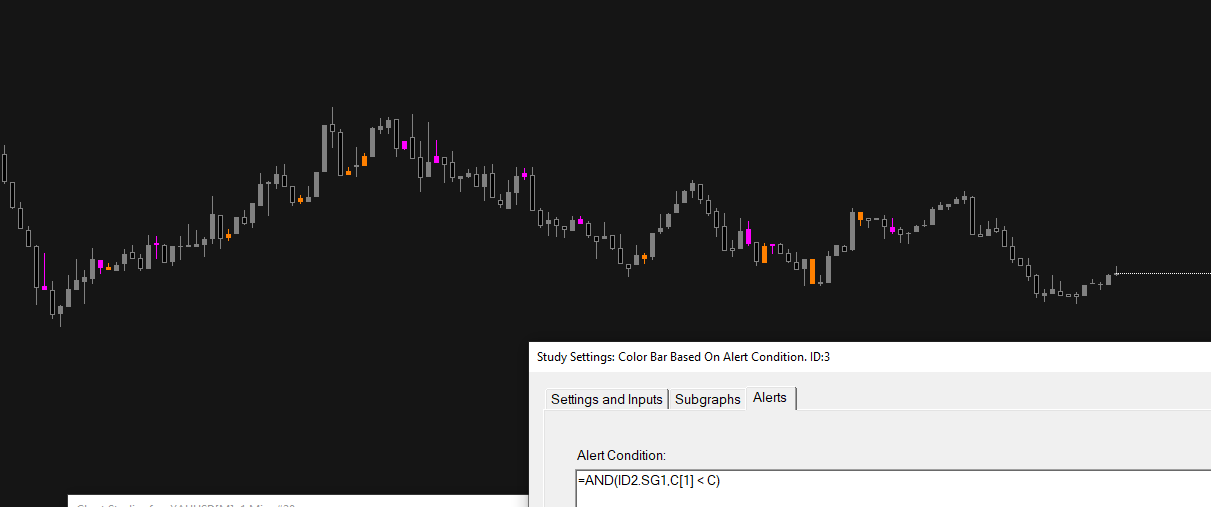

[2024-01-26 03:59:25]
I want to calculate the next bar of insdebar, can I use the following syntax? =AND(ID2.SG1,C[1] < C)
attached photo, but that doesn't work
imageScreenshot_30.png / V - Attached On 2024-01-26 03:59:21 UTC - Size: 19.15 KB - 197 views
[2024-01-26 15:26:05]
In this case, you have to look backwards, since you are dealing with the current bar. So you need to check if the previous bar was an Inside Bar and then check the current close against the previous close. So the formula would be the following:
=AND(ID2.SG1[-1], C < C[-1]

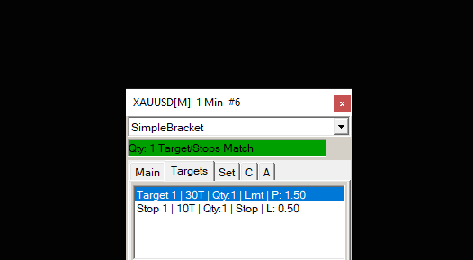

I can use any function to do that job.
utility I am using for automated trading work. But my exit doesn't work. It only recognizes the target at settings.
I have attached pictures
imageScreenshot_32.png / V - Attached On 2024-01-27 03:34:18 UTC - Size: 8.04 KB - 230 views
imageScreenshot_31.png / V - Attached On 2024-01-27 03:34:21 UTC - Size: 3.48 KB - 288 views
[2024-01-29 15:28:10]
Your Exit condition is "HW3+3". Are you really using the HW column for something?
[2024-01-29 16:13:44]
Yes, I use current price + 2 to exit the order. If possible, please text me so I can communicate faster.
[2024-01-29 18:49:08]
This is our main communication method.
Again, we have to ask why you have the formula "=HW3 + 3" The current price is found in cell E3.

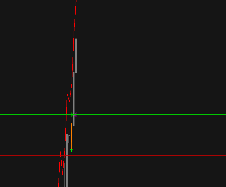

[2024-01-30 04:03:15]
I replaced it with cell E3, I simply set it up like that to test exiting a long position, but see in the attached picture. It is not take profit
and the order entry price is also different from the closing price of the signal candle
imageScreenshot_35.png / V - Attached On 2024-01-30 04:03:11 UTC - Size: 6.52 KB - 273 views
[2024-01-30 15:36:40]
What exactly is your "Buy Exit" formula at this time.
