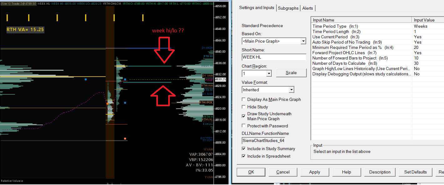

Please explain what I am doing wrong here- Weekly hi/lo clearly is not correct
imageweekHL.png / V - Attached On 2024-01-19 16:43:38 UTC - Size: 68.21 KB - 204 views

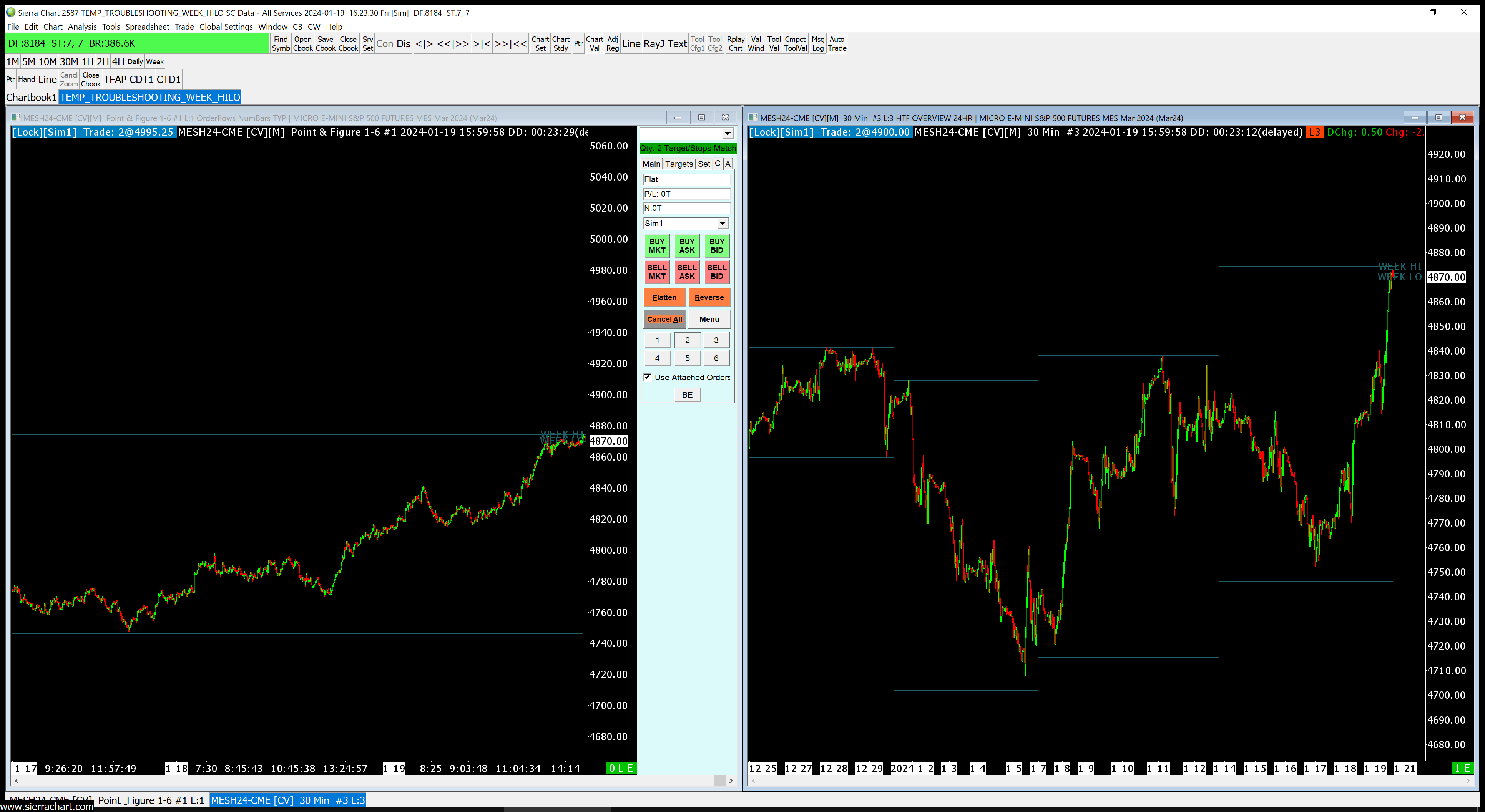

[2024-01-19 22:25:50]
We are not seeing any issues with the charts you sent. Attached is the image of what we see when we open them. You may notice the "Week Lo" up high right by the "Week Hi" label, this is only because it is Friday after the close, so the system is getting a bit ahead of itself for the following week.
imageSierra_Chart_MainWindow_2024-01-19 16_23_28.697.png / V - Attached On 2024-01-19 22:25:47 UTC - Size: 246.63 KB - 286 views

jivetrader - Posts: 410
FIXED- I looked closer at my charts and saw that Fridays were not being included by the Weekly Hi-Lo study. When I turned on Chart Settings> Session Times> Load all Weekend data, this was remedied.
