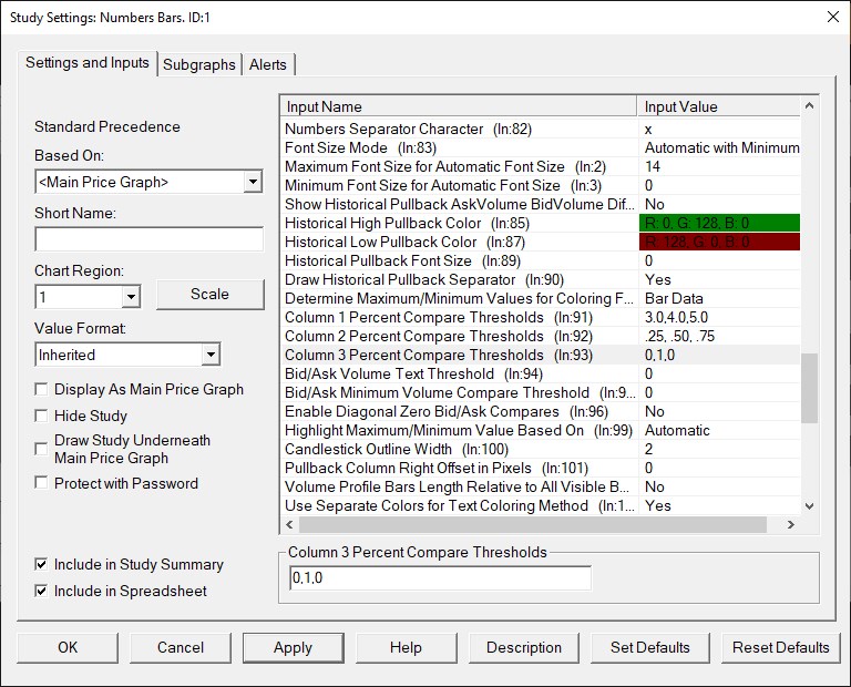

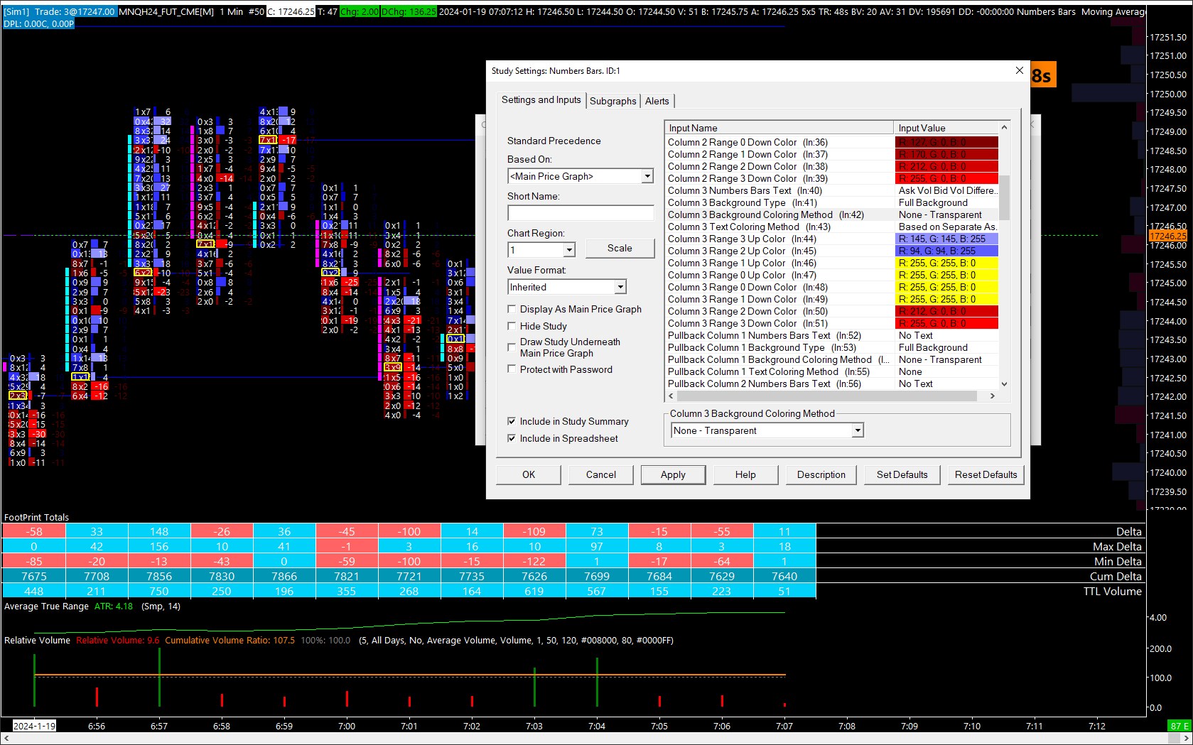

User524616 - Posts: 15
See attached... still no success.. What am I doing wrong

[2024-01-19 16:28:06]
Your third threshold value can not be '0'. You need to change that to at a value of 2, or something more appropriate if you want specific coloring.
[2024-01-19 16:48:36]
still not working after setting it to 3

[2024-01-22 17:11:40]
You need to set both the "Range 0 Up/Down Color for Text" and the "Range 1 Up/Down Color for Text" to white. Otherwise, you will end up with some blend of these first two colors and not see actual white for the text.

[2024-01-22 18:22:27]
Attached is the chartbook with a different name. But keep in mind the way you have it setup, you would only get the White text in Column 3 when the Delta is 0, which will not be very often.

[2024-01-22 21:04:06]
Here is the updated chartbook. We did not realize that you were wanting the delta to be zero, therefore you need to select a different Text display option.
There is not an easy way to have extension lines from the zero delta values until further intersection. You would have to create a custom study to do this. Refer to the following:
