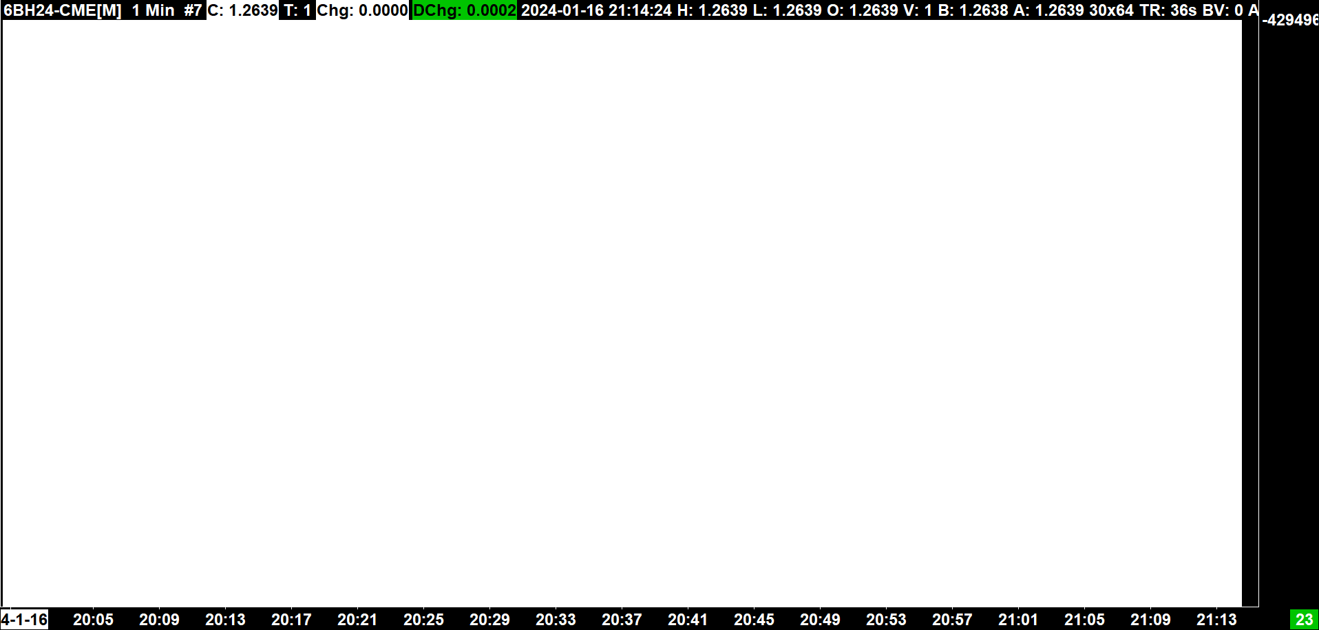

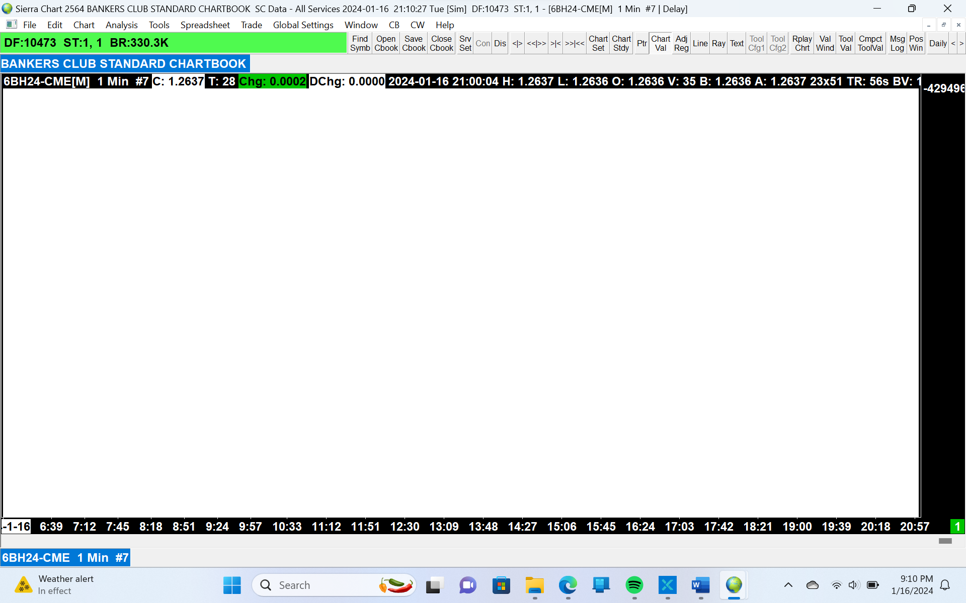

I was creating a VWAP chart with just normal 1 minute candles for pound futures to add to my chartbook. I was changing the days to load for intraday chart to 1500. Then when i went to back test in reply mode sierra started to slow and freeze and said not responding. It eventually worked but the VWAP chart didnt work and every other chart in my chartbook did work. I closed it down and it was white when i stopped replay mode. I restarted sierra and its still white. No idea what i did (i did try play round with data range and limited method before realising it isnt possible and from then sierra was taking a while to work. Any help will be greatly appreciated.

This is a scale problem. Refer to:
Chart Scale and Scale Adjusting: Chart Bars or Studies Not Completely within View, Not Displayed, or Cut Off. Reset Scales.
