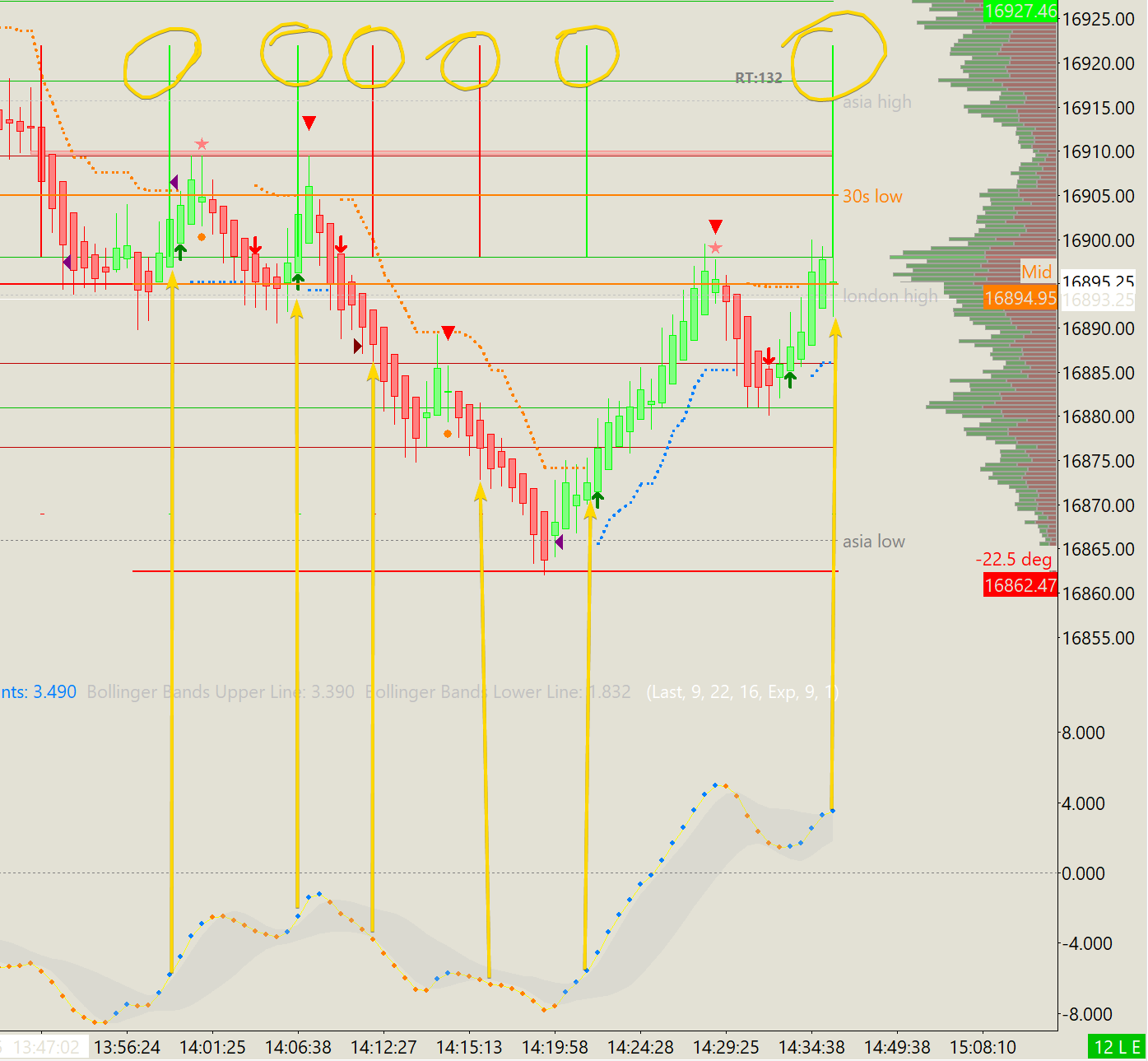

I have been using the color bar based on alert condition for some time - it works very well when you get the alert formulae correct.
My issue is with heiken ashi bars - if i use them the bar is not colored but instead a line is just drawn on the chart (see attached).
My question is how do i get the bar to be colored when using heiken ashi?
Thanks in advance.
imageV19bRm1Lro.png / V - Attached On 2024-01-16 19:43:13 UTC - Size: 117.93 KB - 388 views
[2024-01-16 20:06:12]
We are not able to see any issue when using Heiken-Ashi bars. The Color Bar Based on Alert Condition colors the Heiken-Ashi bars just fine for us.
Is your Heiken-Ashi study set to be the "Main Price Graph"? If not, is your Color Bar Based on Alert Condition set to be based on the Heikin-Ashi study? And are they both in the same region?
[2024-01-17 08:09:53]
TheMatadorTrader - Posts: 23
Thanks for the prompt reply.
1. Th Heiken-Ashi is set for the main price graph - set to region 1
2. The alert is based on the study in region 2 - but it works perfectly unless used with Heiken-Ashi
Please advise.
[2024-01-17 08:48:26]
I figured it out - had to change the scale settings from automatic to same as region!
Thanks!
