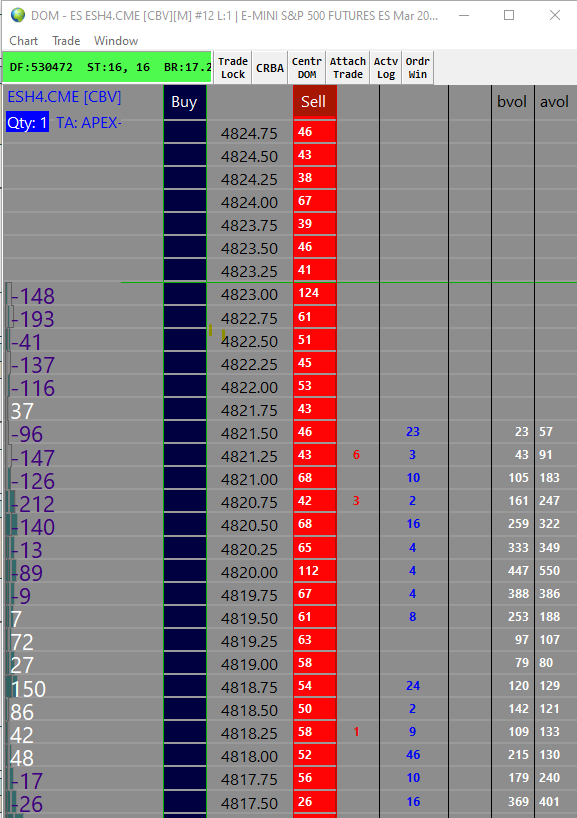

Hi
I have a vbp study on the DOM reflecting Delta
I'd like to add another study showing the Volume as well.
I tried looking to the general purpose column but that could not display it.
Can this be done?
imageDOM Add Study.png / V - Attached On 2024-01-15 22:49:28 UTC - Size: 68.29 KB - 362 views

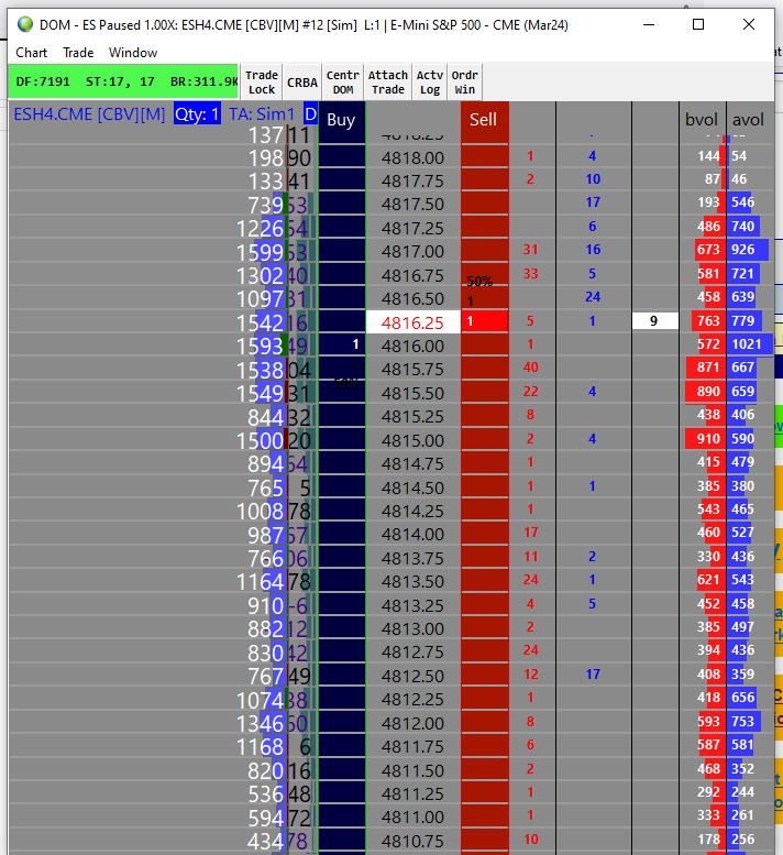

Is there a way to set it up so that the text from volume study does not overlap with delta study
I've attached a screenshot.
imageDOM Add Study 2.png / V - Attached On 2024-01-28 06:17:21 UTC - Size: 92.96 KB - 352 views

John - SC Support - Posts: 47953
Both profiles need to have the Input for "Align to Far Right" set to "Yes". If the default values for other settings are still their defaults, then this should be all you need to do.
But, if the above does not solve it, then check the Input for "Allow Side-by-Side Profiles on Right Side" and ensure this is set to "Yes" for both studies.
