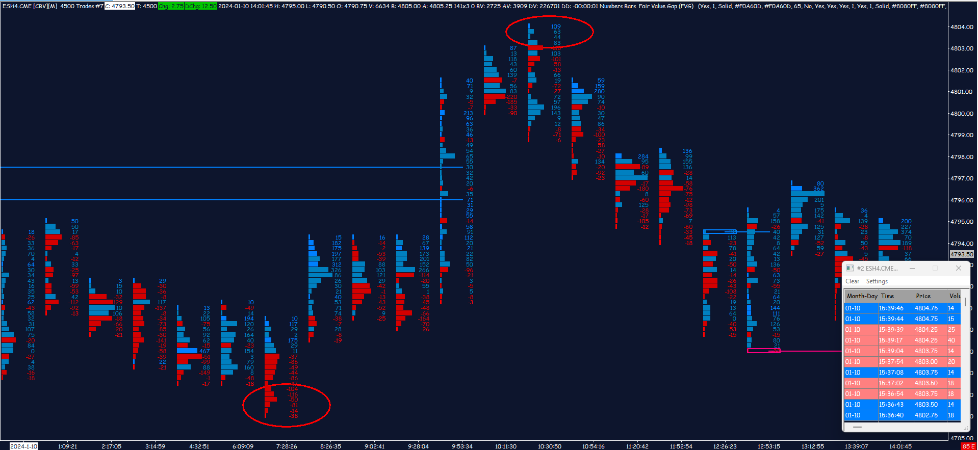

Hello, is there a way to have an "Extension Line until future Intersection" on say 3 or 4 Deltas of the same sign at the Highs or Lows. Example: circles on the attached graph.
image2024-01-10 delta at High Low.png / V - Attached On 2024-01-10 14:46:42 UTC - Size: 125.52 KB - 315 views

Refer to the information at the following link for the "Volume at Price Threshold Alert V2", although this does not have a way to be specific to the High/Low:
Another option would be to use the Color Bar Based on Alert Condition with the alert setup like the following:
AND(AVAP(H, 0) - BVAP(H, 0) > 0, AVAP(H - TICKSIZE, 0) - BVAP(H - TICKSIZE, 0) > 0)
The above will be true when the two highest price values both have a positive delta.
You can then turn on the option for an extension line in the Color Bar Based on Alert Condition. You would want to set the "Input Data" to "High" and the "Output When Condition True" to "Use Input Data".
You would then need an additional "Color Bar Based on Alert Condition" to do the Lows.
You may also want to set the actual "Color Bar" subgraph to "Ignore" unless you want to get the bar colored, or use some other draw style if you want a marker of some kind.
