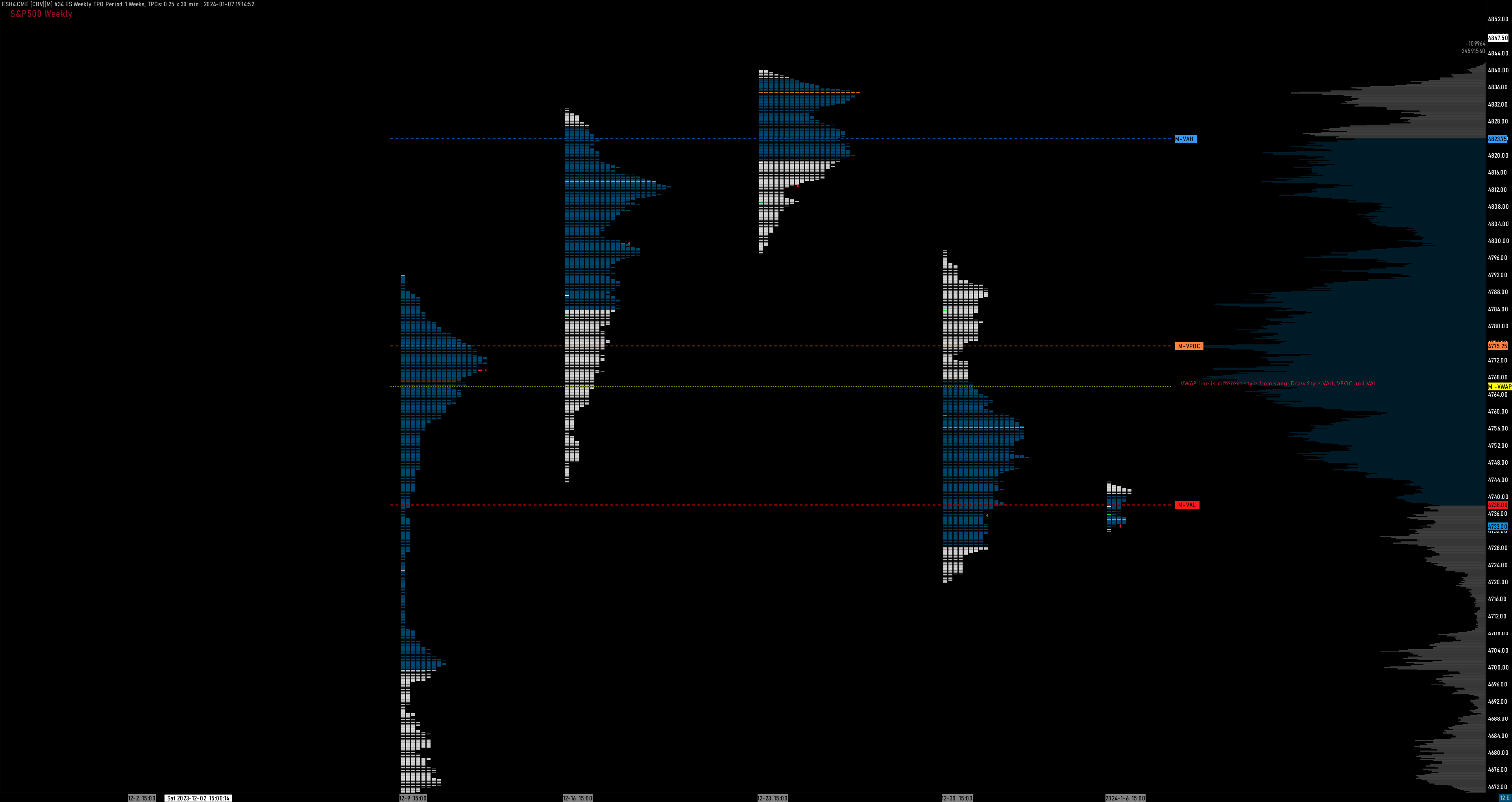

WVAP label alignment on a TPO chart does not seem to show/aligh correctly. When I set the VWAP label Horizontal Align to "Right" it shows up on a price scale but when I set it to "Right Edge" it shows it correctly on the right edge. For some reason, only when set Horizontal Align to "Right" it incorrectly shows the label on the price scale as opposed to show it correctly to the left of the price scale, see attached image. Also, the line does not extend all the way to the scale. Changing setting of the line Draw Style does not seem to affect the appearance and alignment of the VWAP line. https://www.sierrachart.com/image.php?Image=170468369669.png

What you are seeing is due to the fact that you are trying to display this on a TPO chart. Since the TPO chart doesn't really have the individual bars, some of the alignment options do not work in the same way, and you end up getting what the system feels is the best option for what it can do. There is not an option to change how this works.

Interesting, if this is the case, why the other indicators from the same study set, like Vol Area High, VPOC, Vol Ara Low, show up with the correct alignment and with correct lines on the very same TPO chart? Have you been able to replicate this on your end? Thank you for your reply.

Sorry, we thought it was a different situation. But, the reason for what you are seeing is because the VWAP line is actually an Extension Line, which is handled differently than the Subgraph lines are.
