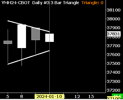

It should signal if current high is below EITHER of the 2 prior bars, and current low above either of the 2 prior bars, not both. It may be set to AND, and is not signaling on valid 3 bar triangles.
Also, could it be possible to have it draw a triangle on the chart as shown?
Thank you!

mkata - Posts: 104
I see, I guess I read that wrong. Given that definition you are going to end up with a lot of signals.
Do this:
1) Use the High/Low over N-bars study set to 3 (ID1)
2) Color Bar Alert Condition: =AND(H<ID1.SG1, L>ID1.SG2)
3) Hide High/Low over N-bars study
