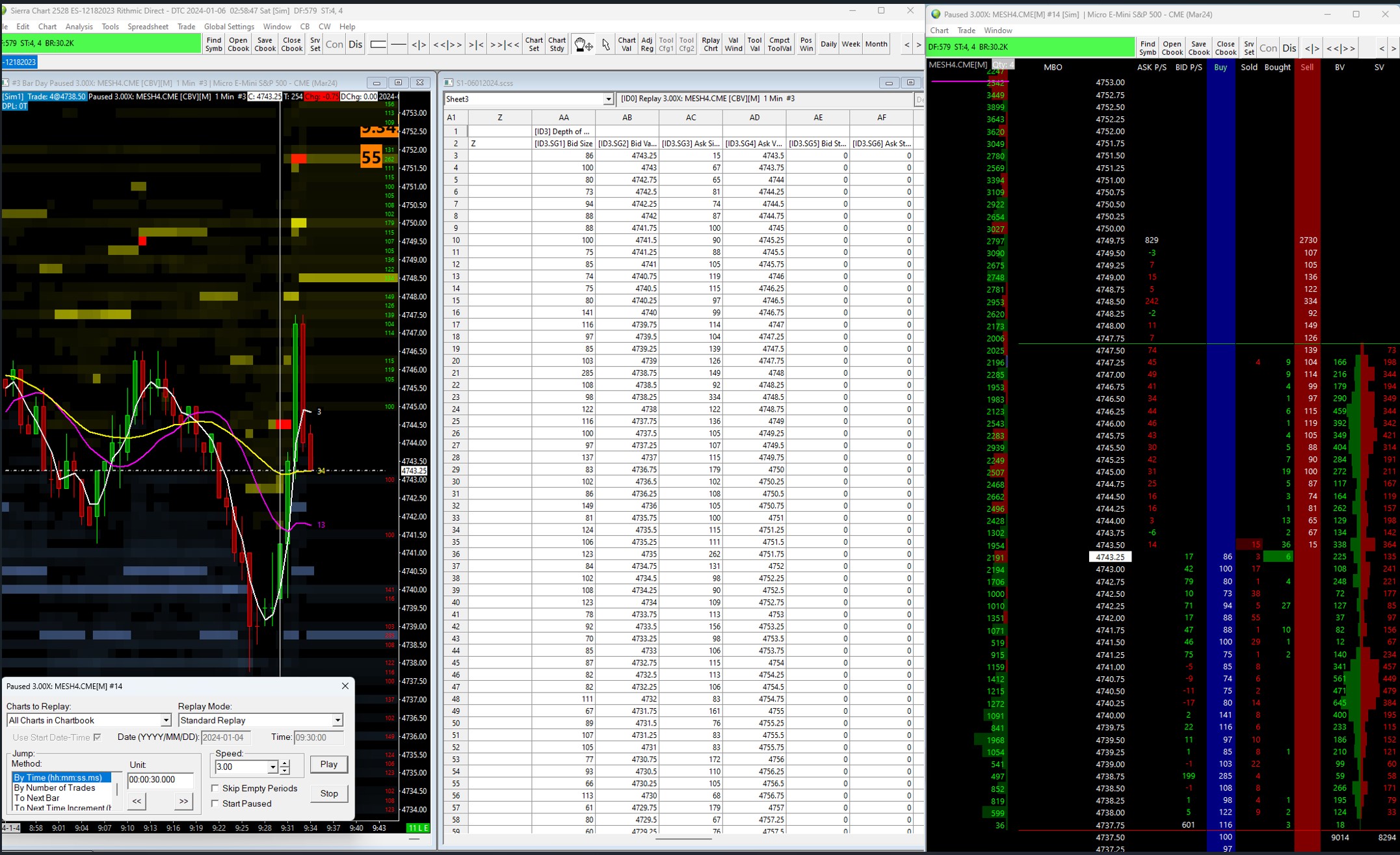

Question regarding Depth of Market Data Study and Spreadsheet Study in replay mode.
When in replay mode, The columns Bid/Ask Stack/Pull values from Depth of Market Data remain zero in de Spreadsheet Study.
I do see values for Bid size, Bid value, Ask size and ask value in replay mode.
Also Bid/Ask pulling and stacking in DOM is working fine in replay mode.
In live trading values for Bid/Ask Stack/Pull values from Depth of Market Data are visible.
How can i get values for Bid/Ask Stack/Pull values from Depth of Market Data in the spreadsheet study when replaying?

We are not seeing any issue with this. When we run a replay with the full market depth data available and the Pulling/Stacking columns displayed, the pulling/stacking information is updated in the spreadsheet study during a replay.
We do notice that if you do not have the market depth data for the period of time of the replay, then you will get the Bid/Ask updating with the 1 value, but you will not see any Pulling/Stacking. Is this the situation you are referring to? If so, then you would need to download the Market Depth data for the period you want to replay. Refer to the following:

I do have market depth for the time of replay. See attached screenshot of yesterdays replay.
There is market depth data on the chart, also Pulling/Stacking data on the DOM.
In the spreadsheet there is output on all columns for Depth of Market data, except for Bid / Ask Stack / Pull Values. These remain zero.

You do not have the Pulling/Stacking columns displayed in the chart that the Spreadsheet Study is on. You need to have those columns displayed on the same chart or you will not get the data.
[2024-01-08 19:18:06]
sabbers - Posts: 28
Got it, thx!
