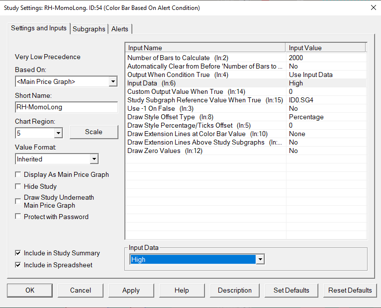

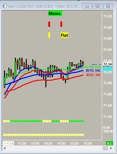

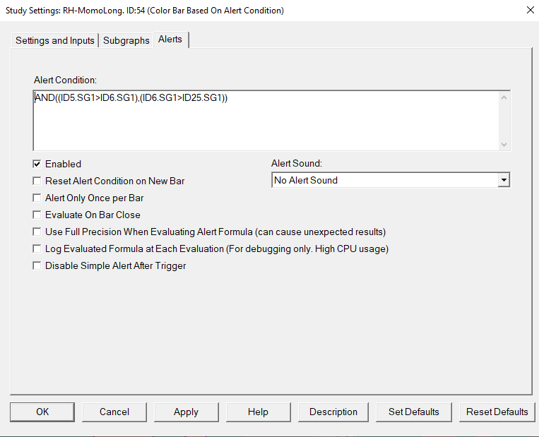

My 5 minute chart has 3 separate Color Bar Based on Alert Condition studies which creates a LONGS/SHORTS/ or FLAT alert and prints the green/red/yellow diamonds for Trend in a lower region based on the alert (attached). I have a second set below that follows Momentum.

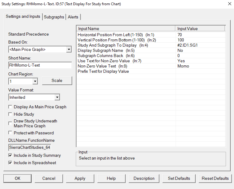

On the 5 minute chart, I also have a Text Display for Study from Chart to display the color result in Region 1 from these two lines of alerts so I can see at a glance what the alert condition is, ie. MOMO/ FLAT example in attached screen capture.
I have been able to use Study Overlay to get the 5 minute Color Bar Based on Alert condition diamonds on the Flex-Renko-Inverse chart lower region, however, I have not been successful in getting the Text Display for Study from Chart of the 5 minute on the Region 1 of the Flex-Renko-Inverse chart so I will know this information from the 5 minute on the Renko chart.

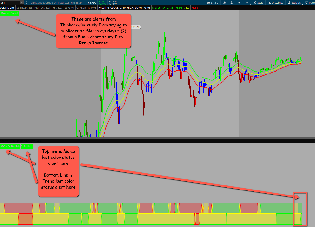

On the 5 minute chart attachment 2014-01-04-15-41-33.png I provided you. Here is an attachment of the ThinkorSwim alerts/study chart that I am trying to duplicate on Sierra. 2024-01-05_18-16-45.png
Yes, on my 5 minute Sierra Chart, do you see the word "Momo" with Green Background on the 5 minute chart, and the next level below that is a red block and the word FLAT in yellow background on the third level down? Those are the Text Display that are color matched to the status of the alert on the bottom two diamond lines, currently Green diamond on first line of alerts and Yellow on the 3rd line of alerts.
I have not been able to have the alert position on the left as it is on Thinkorswim so I just had to set the vertical/horizontal place for each of the alerts, green/red/yellow for each Momo or Trend line. I would prefer to have the alert condition in the upper left corner, but when I had them set to the same location, the overlap was not accurate and the edges bled beyond the box.
