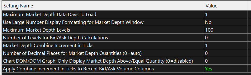

Hi, like the title says the option to combine ticks for the recent bid/ask volume stopped working for me after yesterday's update. Idk if it just got disabled or something but I have it set to yes on the settings and it doesn't do anything, it stays on the default tick size.
[2023-12-29 17:35:14]
Sorry, but there were a few issues with it, so we had to pull it back out for a bit. It will be released again soon.

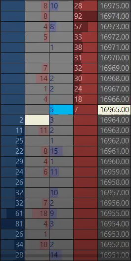

Hello, I just updated to version 2586 and am getting overlapping recent bid/ask columns. Should I go to the previous version?
imageoverlapping.PNG / V - Attached On 2024-01-15 15:41:54 UTC - Size: 13.35 KB - 215 views

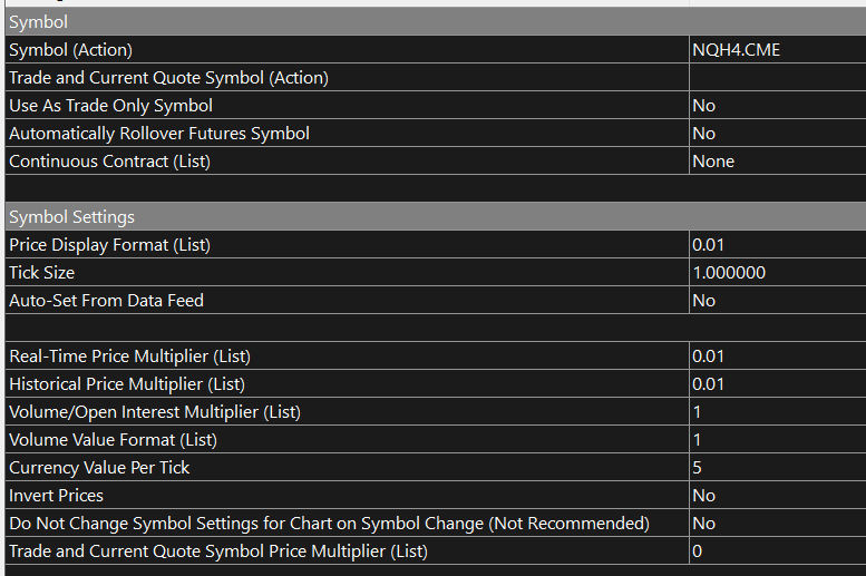

[2024-01-15 17:35:42]
BonoboTrades - Posts: 8
John:
Symbol is: NQH4.CME
imageSettings.PNG / V - Attached On 2024-01-15 17:35:22 UTC - Size: 24.42 KB - 275 views
imageapply combine.PNG / V - Attached On 2024-01-15 17:35:28 UTC - Size: 18.01 KB - 349 views
[2024-01-15 17:53:06]
We see you have the Tick Size set to 1.00 and the Combine Increment in Ticks is set to "1".
Can you please try setting the Tick Size to "0.25" and the Combine Increment In Ticks to "4".
Let us know if the problem persists or not.
If you have a reason to have the tick size set at 1.00 then after you try the above, go ahead and change back (unless the above resolves the issue and you then want to keep it like this).

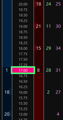

[2024-01-15 18:53:59]
I was unable to achieve the desired result shown below.
However, I can create a volume by price study in a different chart that will get me the data I need.
Thank You.
imagerecent bid.ask.PNG / V - Attached On 2024-01-15 18:53:48 UTC - Size: 130.24 KB - 385 views
[2024-01-15 22:11:45]
Sorry, not volume by price. I meant the numbers bars chart. I could set the tick size to 1.00 and it will give me the combined recent bid and ask on the NQ.
