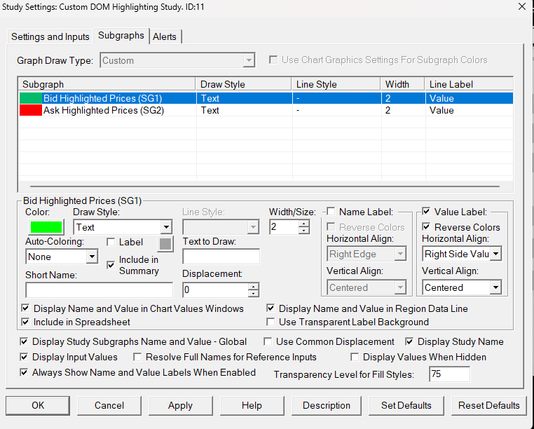

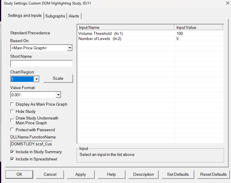

I want to create a study for the Trade Dom, whereby prices in the price column are highlighted where pulling/stacking column volume is >=100 on both Bid pull/stack and Ask pull/stack.

Please see above my current attempt, with some screenshots of the current state of affairs.
I wondered if someone could help me as I'm at a loss as to how I make it function lol
