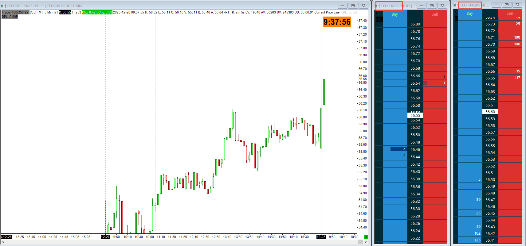

I tried using _MBO suffix before, but that did not work for me as expected. It was simply not showing market depth. Then I tried using it yesterday in the afternoon on a random ticker CELH and it worked. Today right after market open it does not work again - if I compare DOMs of "CELH_MBO" and "CELH-NQTV", I clearly see that NQTV show more levels. I am attaching a screenshot.
image2023-12-28_16-38-12.png / V - Attached On 2023-12-28 14:42:21 UTC - Size: 79.34 KB - 205 views
[2023-12-29 06:03:10]
This may be a problem on our side. We are going to have to look into this. This will take some time. We do not know how soon it can be resolved.
It could also be because you are using Interactive Brokers.
However, we do think there is a problem on our side, with market depth with _MBO symbols.
