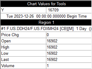

In FDAX I get a candle on 26.12.(see pic), but it is wrong. How can I delete it?

This chart is based on Intraday data. Therefore, edit the Intraday data to remove the data from that date:
Intraday Data Editor
Or you can use this Chart Setting:
Chart Settings: Set Dates To Exclude (Button) (Chart >> Chart Settings >> Chart Data >> Chart Data menu)

nicktrader - Posts: 817
I have corrected the error. Thank you very much.
But unfortunately I lack the logic. EUREX was closed on 25.12. and 26.12. Both days were a weekday, but only on 26.12. a file was displayed. Why not on 25.12 as well?
The FESX had the same error.
[2023-12-28 05:42:59]
We do not know. If this data was found in an Intraday chart it means that data was actually transmitted by the exchange. On the T7 feed.
