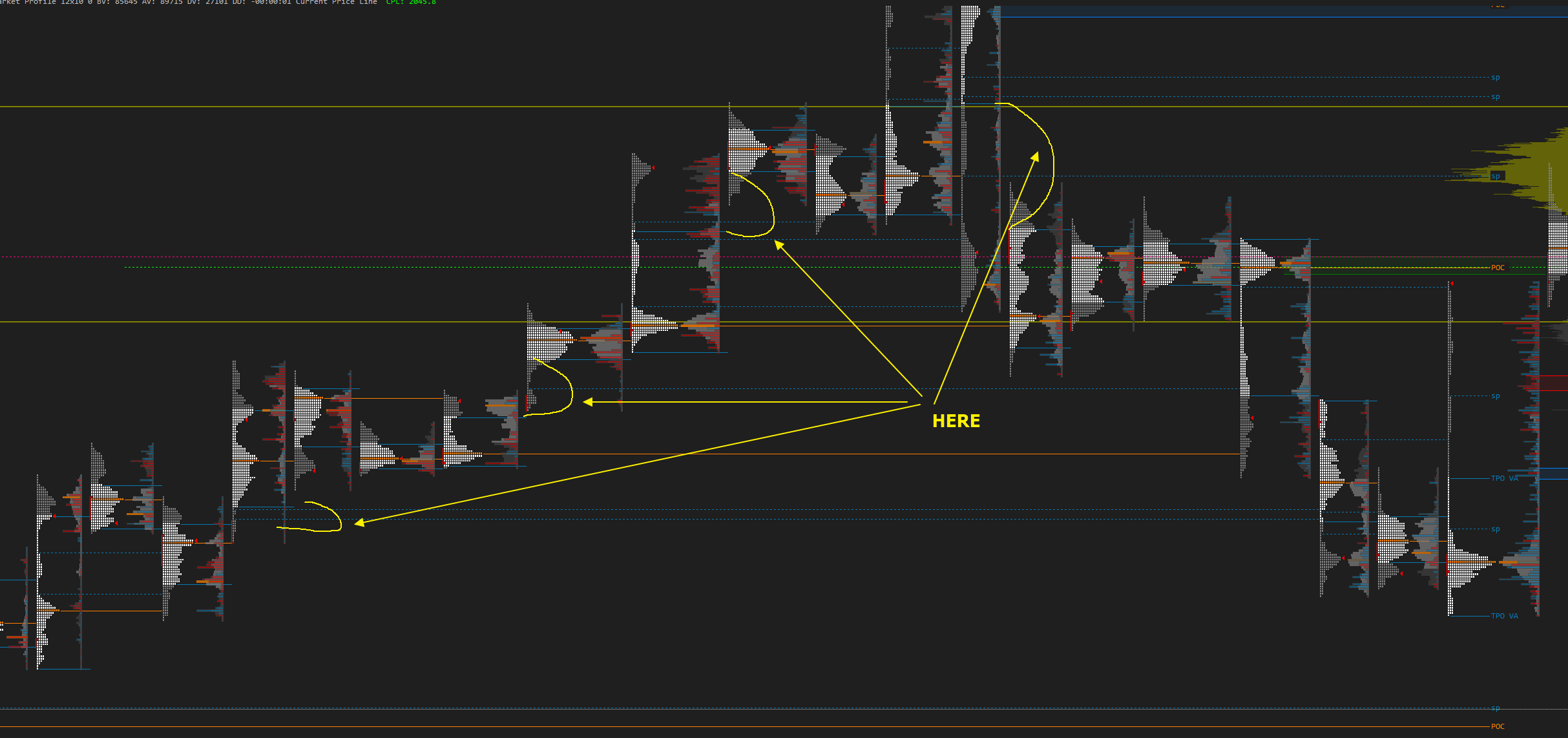

I want to generate a signal when a VA Gap appears. As shown below:
image2023-12-21 18 08 21.png / V - Attached On 2023-12-21 19:54:25 UTC - Size: 83.97 KB - 222 views

The Value Area Levels are not directly available through the TPO chart, so you would need to have another chart and use the "TPO Value Area Lines" study to have access to that information.
Then use the Simple Alert syntax to create the alert that you want to make. We are not certain of exactly the circumstance you want to create, so we can not give an exact example, but be sure to refer to the following for how to reference Study Subgraphs in the alert, so you can reference the Value Area High and Low from the TPO Value Area Lines study:
Study/Chart Alerts And Scanning: Referencing Other Studies on the Chart
