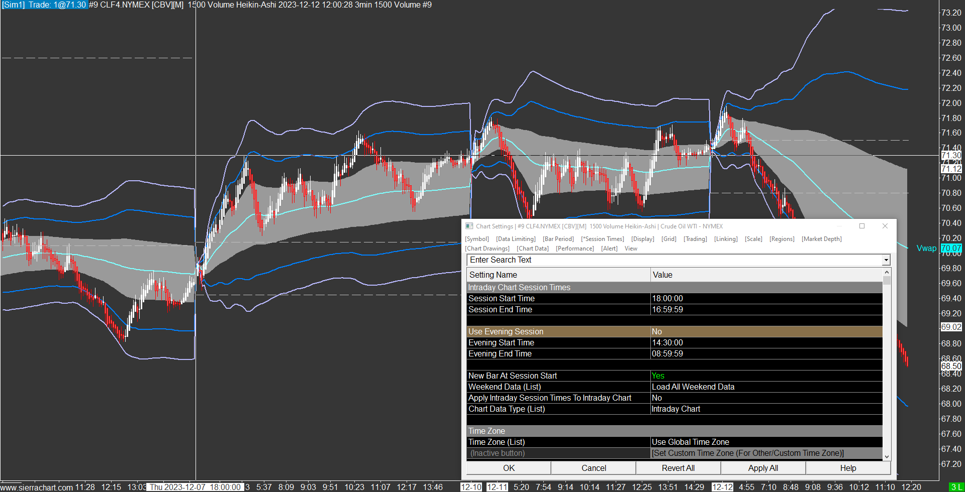

AzharBasri - Posts: 29
Yes, I already have them setup as you said.
Here I attached the picture of intraday chart using RTH Session Start Time that showing the correct TPO Value Area Lines for previous day RTH but my VWAP indicator will start at RTH Session Start Time rather than my preferred Globex Session Start.
I would like my intraday chart with my VWAP indicator to start at Globex Session Start Time. But if I change the Session Start Time to Globex Session Start Time, the calculation of the of the TPO Value Area Lines will account the whole Globex Session.
Is it possible to specifically mention the start and end times of the TPO Value Area Lines inside the study rather than relying on the Session Start Time since I want to use 2 different start time for each VWAP and TPO Value Area Lines.
Thanks.
https://www.sierrachart.com/image.php?Image=170240033775.png
https://www.sierrachart.com/image.php?Image=1702400432281.png
