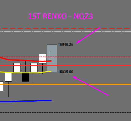

I am thinking of moving back to SC and want to know if this is possible to do? A study or what have you that will show what the hi/lo of a renko would be when it closes. I attached a screen shot of what I mean.

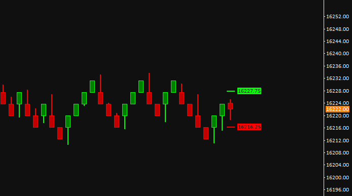

[2023-12-11 20:06:30]
Jaydtrade - Posts: 125
Would you possibly have a screen shot of what this actually looks like on the chart? : )
[2023-12-11 20:38:08]
User431178 - Posts: 910
Yes, attached, though you can obviously configure it how you want.
imagebar predictor.png / V - Attached On 2023-12-11 20:38:03 UTC - Size: 13.32 KB - 190 views
[2023-12-11 20:39:57]
Thats exactly what I was hoping for thanks for the help sir!
