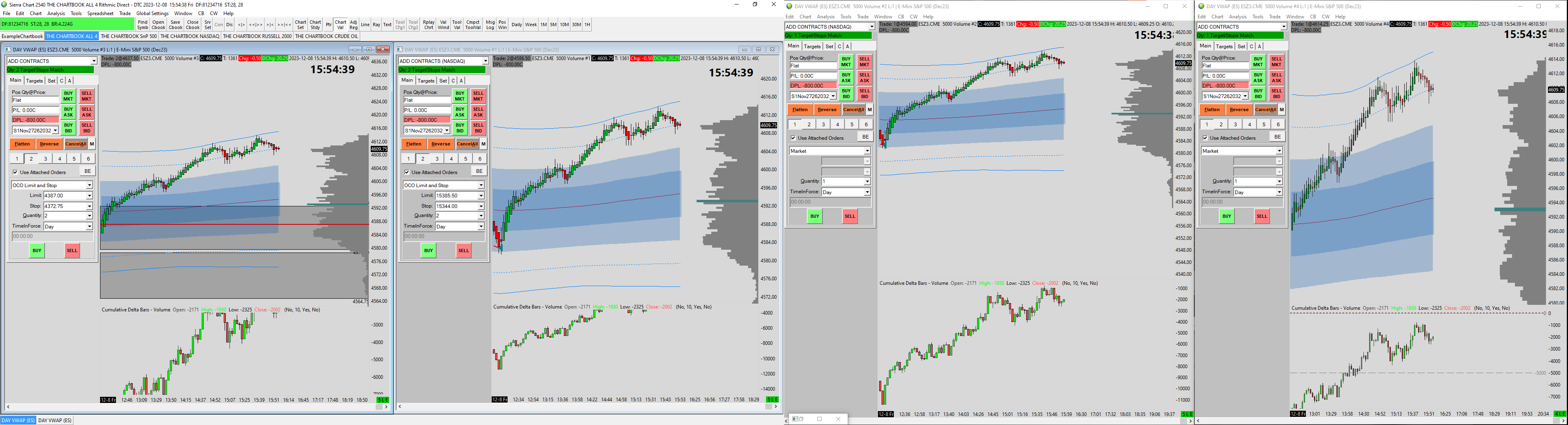

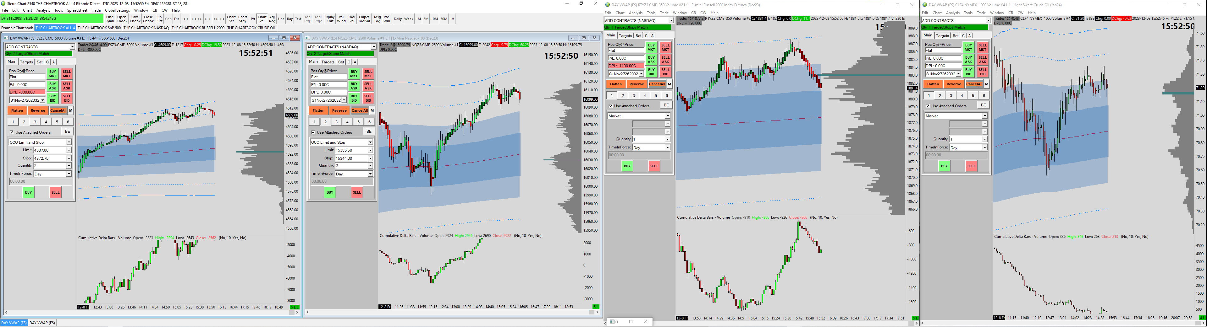

Sweet so that worked but when i copy the drawings of one of the charts in my chatbook to another all four of the charts change to the same symbol as you can see in the attached images, is there anything i can do to keep them as the same symbol?
imageScreenshot 2023-12-09 075300.png / V - Attached On 2023-12-08 20:57:59 UTC - Size: 282.22 KB - 499 views
imageScreenshot 2023-12-09 075447.png / V - Attached On 2023-12-08 20:58:09 UTC - Size: 281.29 KB - 339 views
[2023-12-08 21:35:00]
John - SC Support - Posts: 48440
This would not have anything to do with the drawings. In fact, if you are copying the drawings from a chart with a different symbol, you would have to enable the option for "Show Chart Drawings For Different Symbols".
The charts changing symbol would be due to linking. We see that all the charts are setup to use Link Number 1. You must have the Symbol linked between the charts. Refer to the following:
Chart Settings: Linking
