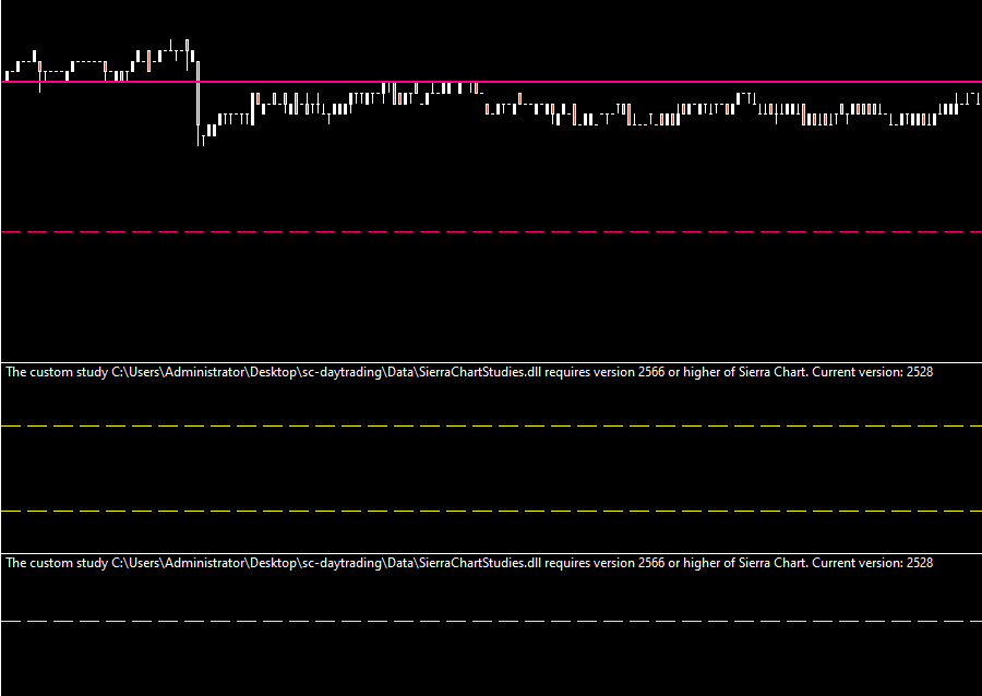

I think I might be running something in between 2564-2568, because I remember updating to 2567 over the weekend. And that caused issues with all my studies, started showing "failed to load custom study at C:\users..." in the Studies window.

Found an example of the failure to load study point I was talking about in the last message. Attached.
This was an older version, 2528, from another desktop I use. I will try to add a spreadsheet and update to Current version and get back, in case I have a repro of today morning's debacle. Thanks.

The issue in post #8 is unrelated. It means you have to update Sierra Chart to run the version of the study you have.
