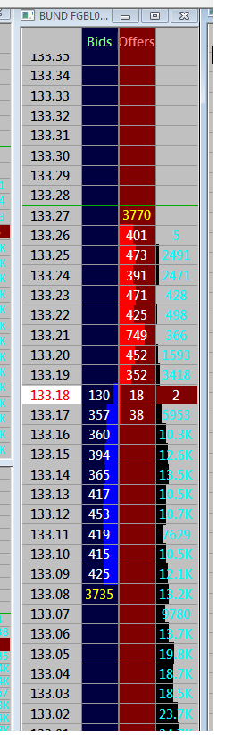

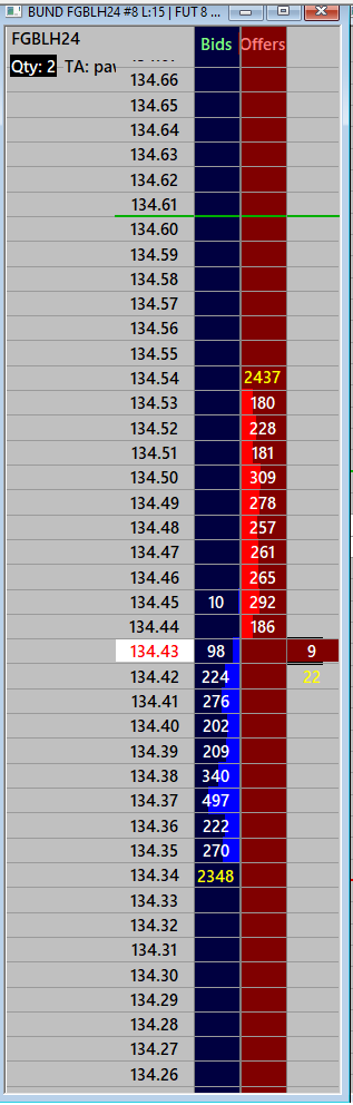

Hi.
please take a look at the attached screenshot.
The symbol is FGBLH24 on EUREX; Service is trading evaluator. I use Denali Data Feed.
I compared it with tradovate and their DOM is fine.
I use SC 2543
Date Time Of Last Edit: 2023-12-05 13:31:06
imagebund_bid_ask_overlap.png / V - Attached On 2023-12-05 13:21:29 UTC - Size: 28.46 KB - 327 views
imagebund_bid_ask_overlap2.png / V - Attached On 2023-12-05 13:30:58 UTC - Size: 30.24 KB - 251 views

Updating Sierra Chart will have no effect on this. We do see a few packets lost today with EUREX. This is what will lead to the problem. We will see if there is anything we can do to resolve this.
Date Time Of Last Edit: 2023-12-05 14:58:52

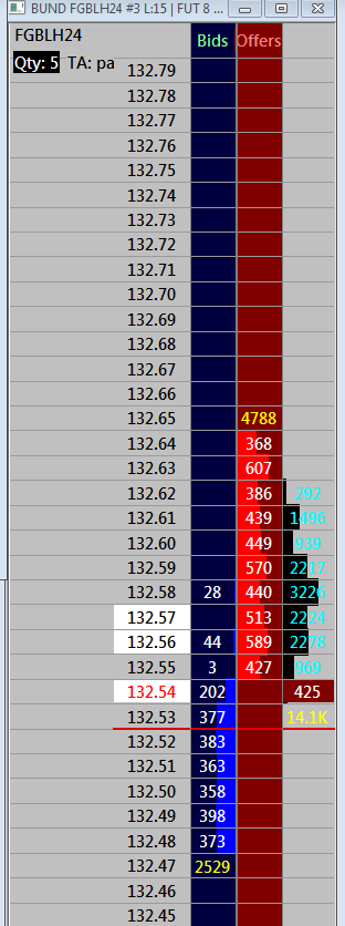

User282741 - Posts: 38
This happens again today on BUND. Take a look at the attached picture.
I looked at exchange data from Tradovate and it works well there. No such problems there.
Date Time Of Last Edit: 2024-03-04 08:14:50
imagebund_overlap.png / V - Attached On 2024-03-04 08:14:22 UTC - Size: 26.14 KB - 201 views
[2024-03-04 08:22:00]
We see an indication of this. There is not anything we can do now but we will be looking at this, in the evening to see what can be done.

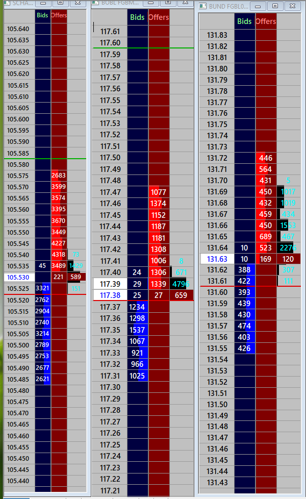

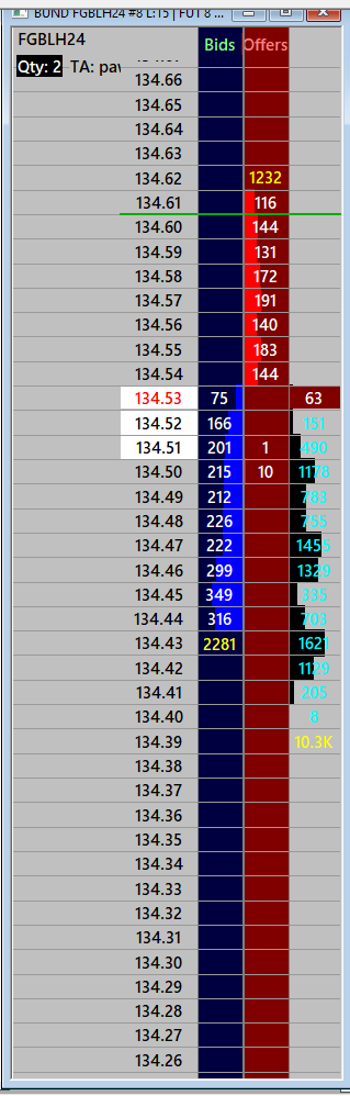

[2024-03-18 10:00:53]
This still happens.
I'm on the current release.
Reconnecting does not help
Symbol is FGBL0624.EUREX; FGBM0624.EUREX, FGBS0624.EUREX
Please fix this. I know you have the most advanced data feed. But it's of no use if the DOM your present is totally confusing.
And I doubt it's EUREX's fault. I see the DOM on Tradovate and it's correct. No overlaps.
Date Time Of Last Edit: 2024-03-18 10:04:24
imagebund_error.png / V - Attached On 2024-03-18 10:00:27 UTC - Size: 55.54 KB - 249 views
imagebund_error_2.png / V - Attached On 2024-03-18 10:03:36 UTC - Size: 88.72 KB - 186 views
[2024-03-18 14:30:50]
This is actually not something we can fix. It is very difficult/impossible to resolve even if there is just a few packets lost.
You cannot compare what Sierra Chart offers to other programs.
We actually can fault EUREX for this because they do not provide the best bid and ask prices as a reference point.
[2024-03-18 14:37:46]
This particular problem was pointed out to EUREX from the very beginning. They need to provide the best bid and ask price for symbol as a reference. They do not do that on the EOBI data feed.
The fault does lie with EUREX. That is the only fair thing to say here.
Date Time Of Last Edit: 2024-03-18 14:38:16
[2024-03-18 15:11:24]
We are going to make one change, which triggers the automatic deletion of overlapping levels, occur with less tolerance.
