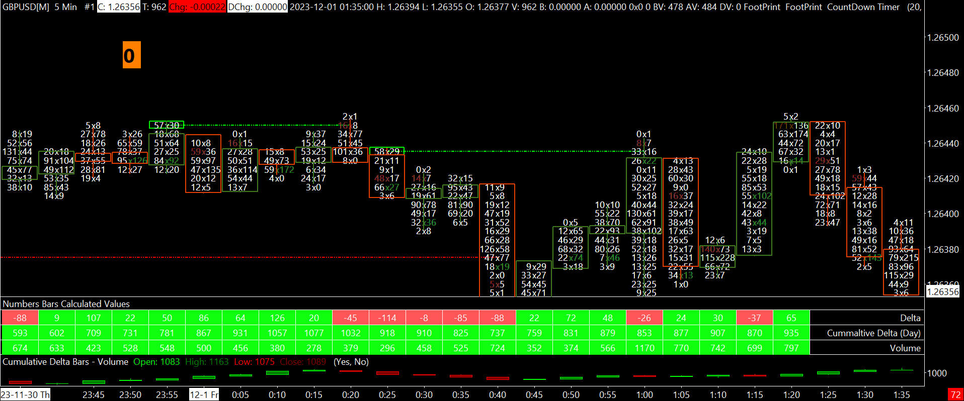

if anyone could help, im having problems figuring out how to set an alert for when the threshold is 49 for the Numbers study (footprint) subgraph nonzero Bid&ask Vol at High/Low Highlight & Extension Lines (SG3). not quite understanding the process ...thanks

Thank you, John I use the numbers bar study (footprint) to plot unfinished auctions and would like to if there's any way to get an alert when an unfinished auction, according to the settings in the numbers bar, would fire off an alert when the threshold is above 49.
hopefully I've explained what it is that I'm trying to accomplish well enough.
[2023-12-02 15:07:41]
thaundadogfx - Posts: 4
https://www.sierrachart.com/image.php?Image=1701529544223.png
This is an image of the alert I would like to be sent
