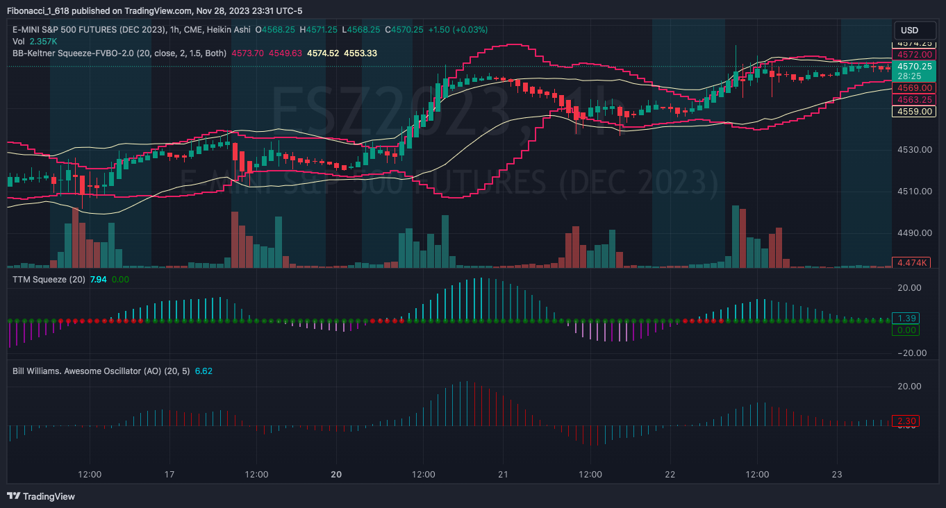

My suggestion was to use the Awesome Oscillator or Bill Williams Awesome Oscillator studies to replicate the TTM Squeeze Momentum Histogram. Set the Moving Average Length to 20. See the attached image from Trading View. The Awesome Oscillator is a good approximation of the TTM Squeeze Histogram.
My other suggestion was to only use the Bollinger Squeeze 3 study "Squeeze Dots" added to the same region as the Awesome Oscillator to replicate the TTM Histogram Squeeze dots.

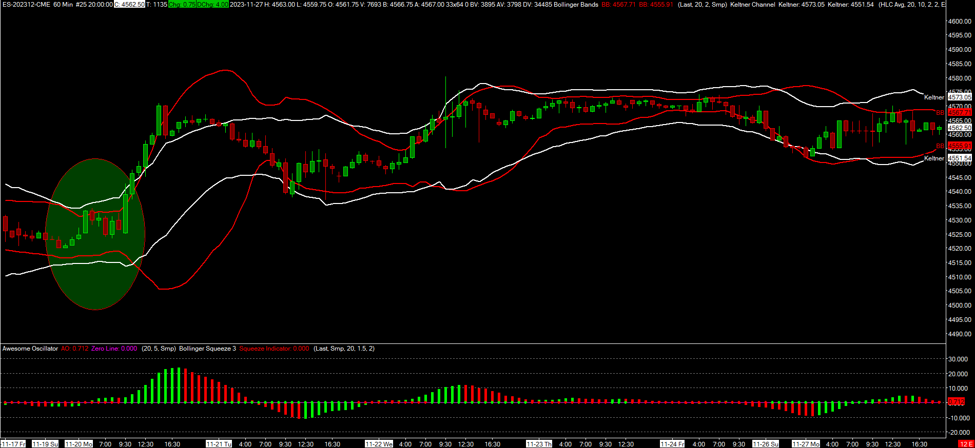

The Squeeze happens when the Bollinger Band moves inside of the Keltner Channel. See the ellipse in the image below.
https://www.sierrachart.com/image.php?Image=170122801298.png
