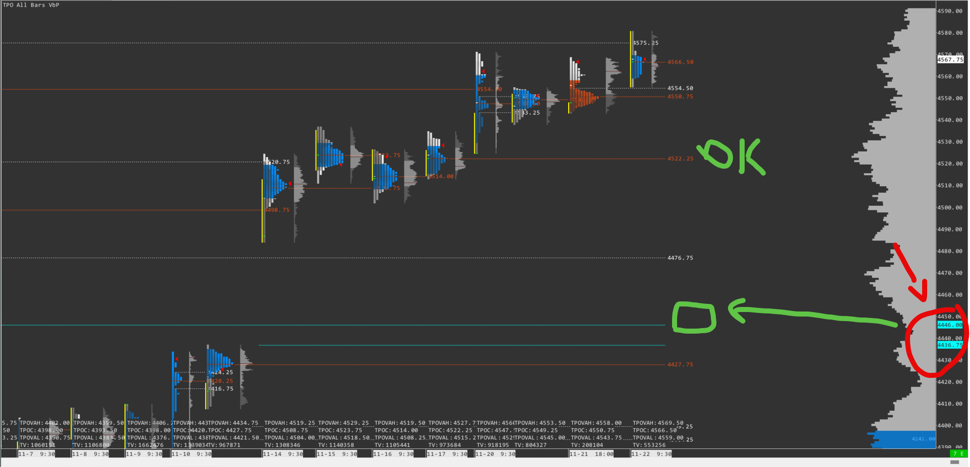

1/ Is it possible to have the label next to the line and not in the scale? Like if I set the value label to align horizontally to the right

Federico Roveda - Posts: 40
I have attached a screenshoot with the desiderata for point 1 above. Hope this explains better my request. Thanks

[2023-11-22 16:53:40]
John - SC Support - Posts: 48438
The way the "Extend Line Until Future Intersection" option works (which is what is used in the "Extend Bar Gap Until Future Intersection" study) is that it will display the label next to the line if there is an intersection, otherwise it displays it in the Values Scale.
There is no option to change this, and it is not something we can get to changing any time soon.
