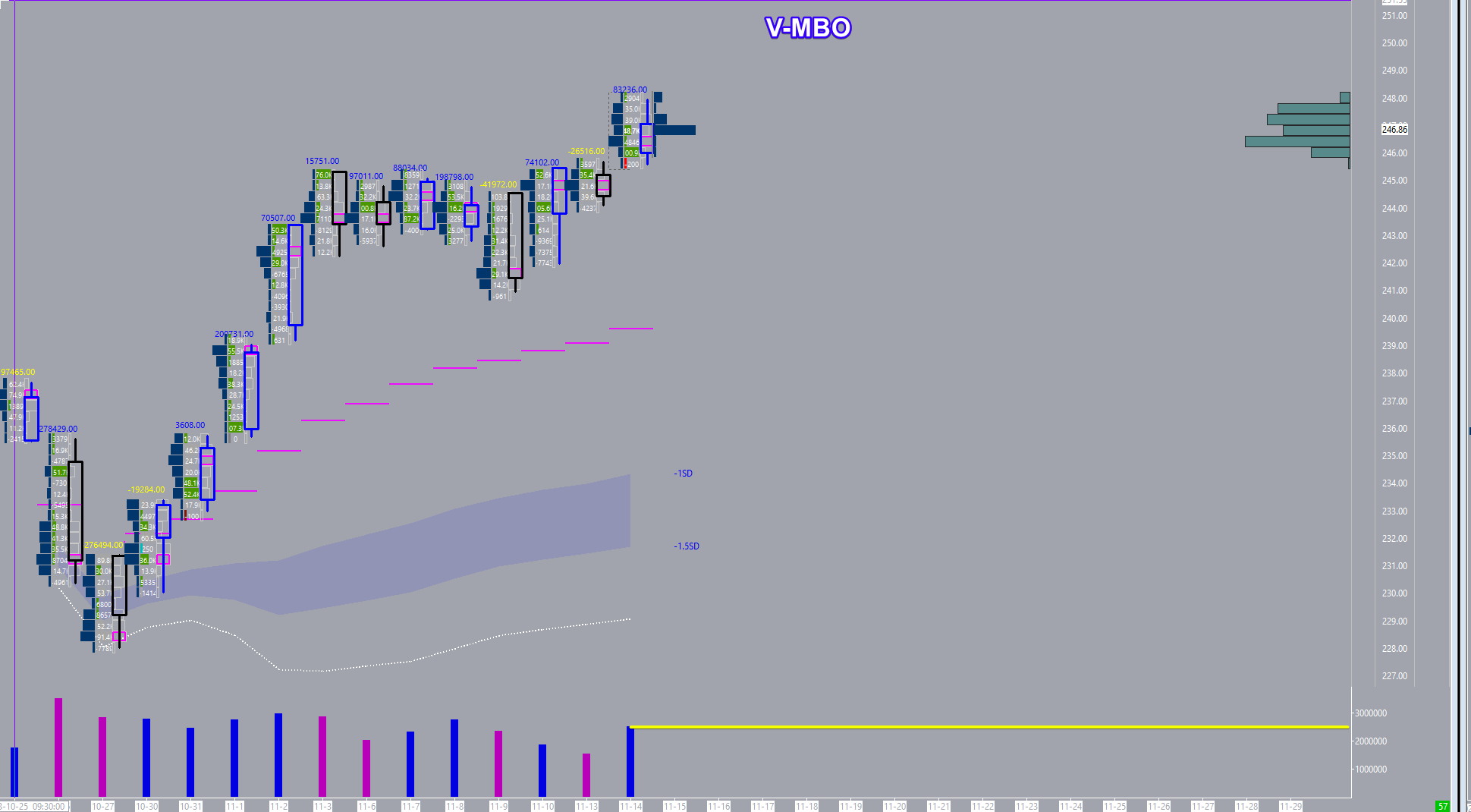

I subscribed to both stocks feeds yesterday. The data is still incomplete. For example, V_MBO is showing today's volume around 3million. Both tradingview and thinkorswim are showing > 14 million. This is makes a difference as this is a breakout bar, and the volume might make a difference in making a trading decision.
Also, I'm only able to see the last month of data for daily bars. The historical data is incomplete as well.
Please see attached picture.
Thank you for any help.

[2023-11-15 16:06:23]
Regarding your question, refer to:
Differences With Data and Chart Bars Between Services / Connections / Chart Types: 43.7 - Comparing Daily Volume to Intraday Chart Bar Volume
For fast and reliable long-term history you need to use a proper Historical Daily chart. You need to change the Chart Data Type to "Historical":
Chart Settings: Chart Data Type (Chart >> Chart Settings >> Data Limiting >> Date Range and Limiting Method)
In the case of Intraday data which you are currently using:
Historical Intraday Data (Missing Data / Download Errors / Viewing More Data): Downloading/Viewing More Historical Intraday Data

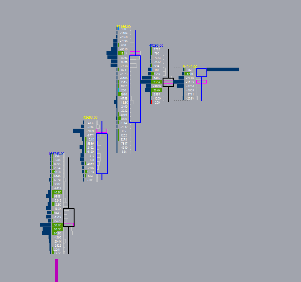

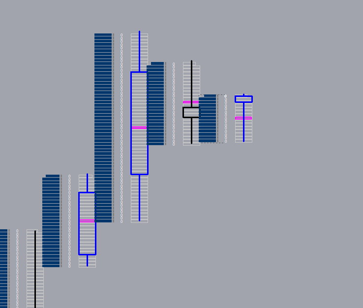

The reason I do not use the historical chart is because the number bars do not work on that bar type. Pleas see attached. My intention was to obtain the delta levels and bar volume profile for stocks on a daily timeframe .
I understand why the daily TF may show different volume, it's just not an ideal situation. Maybe I can have both charts open and superimpose volume from one on the other.
Thank you.
EDIT: I figured it out. I jsut created a chart like you suggested , and added the indicators, then superimposed on the intraday daily charts. Thanks.
