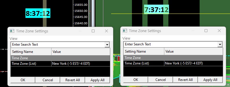

Since the time change my 2nd instance (SierraChartinstance_2) of SC has been behind by 1 hour. Both the main instance and the second instance have the same Time Zone settings so I am at a loss. My main instance is correct (8:37:12.) The Second Instance (7:37:12) fell back 2 hours instead of 1 with the time change. Any ideas to try for a fix?

imageCLOCK 2023-11-13 .jpg / V - Attached On 2023-11-13 13:58:46 UTC - Size: 54.13 KB - 245 views

You have to change the time zone in that chart itself. Refer to:
Time Zone Setting: Using Different Time Zone in Individual Charts
