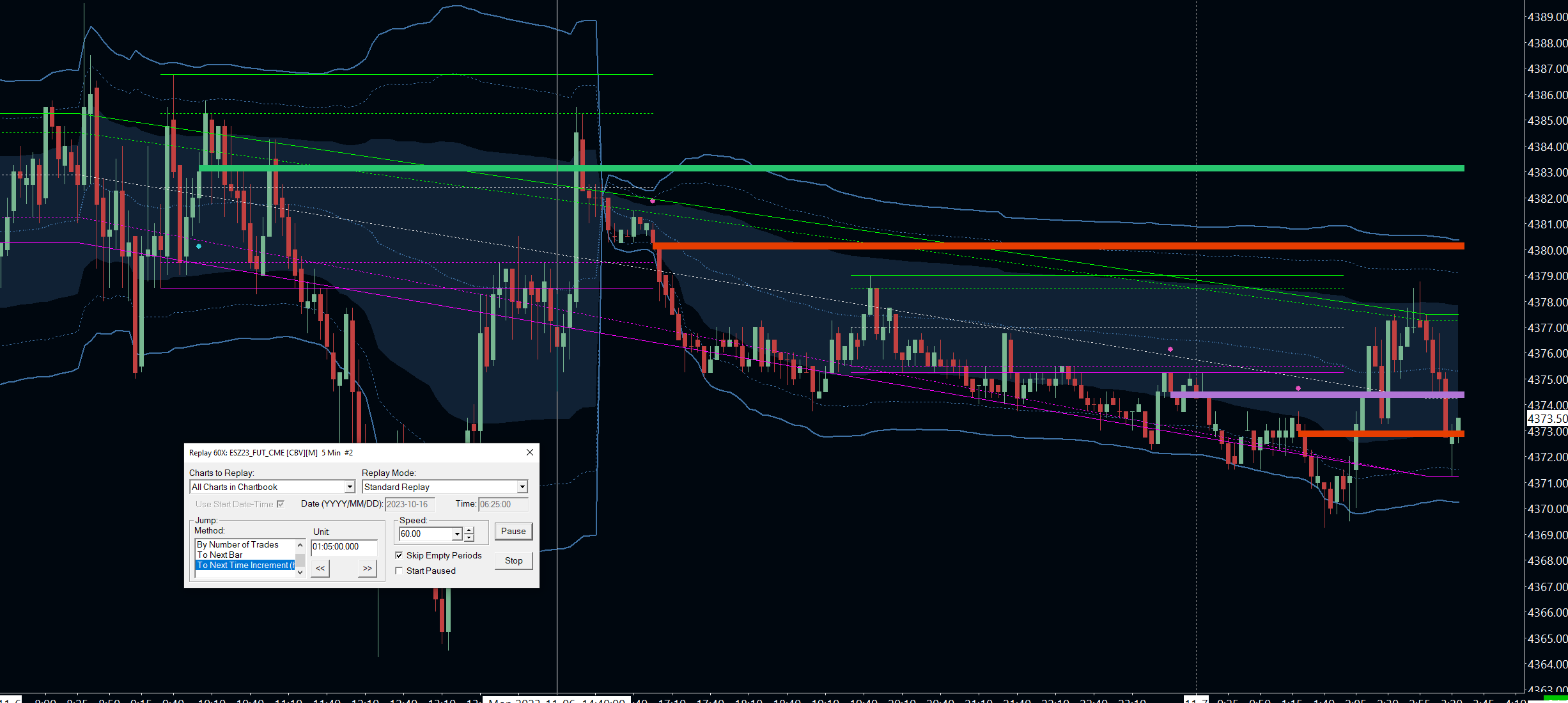

Looking for some programming help. I'm working on an indicator that will draw rectangles based on my criteria. Currently, I have a for loop that draws each rectangle. When I'm in the chart normally, everything works perfectly. When I go into replay mode, I lose the opacity of the lines.
Image 1: What it should look like. Transparency set to 65

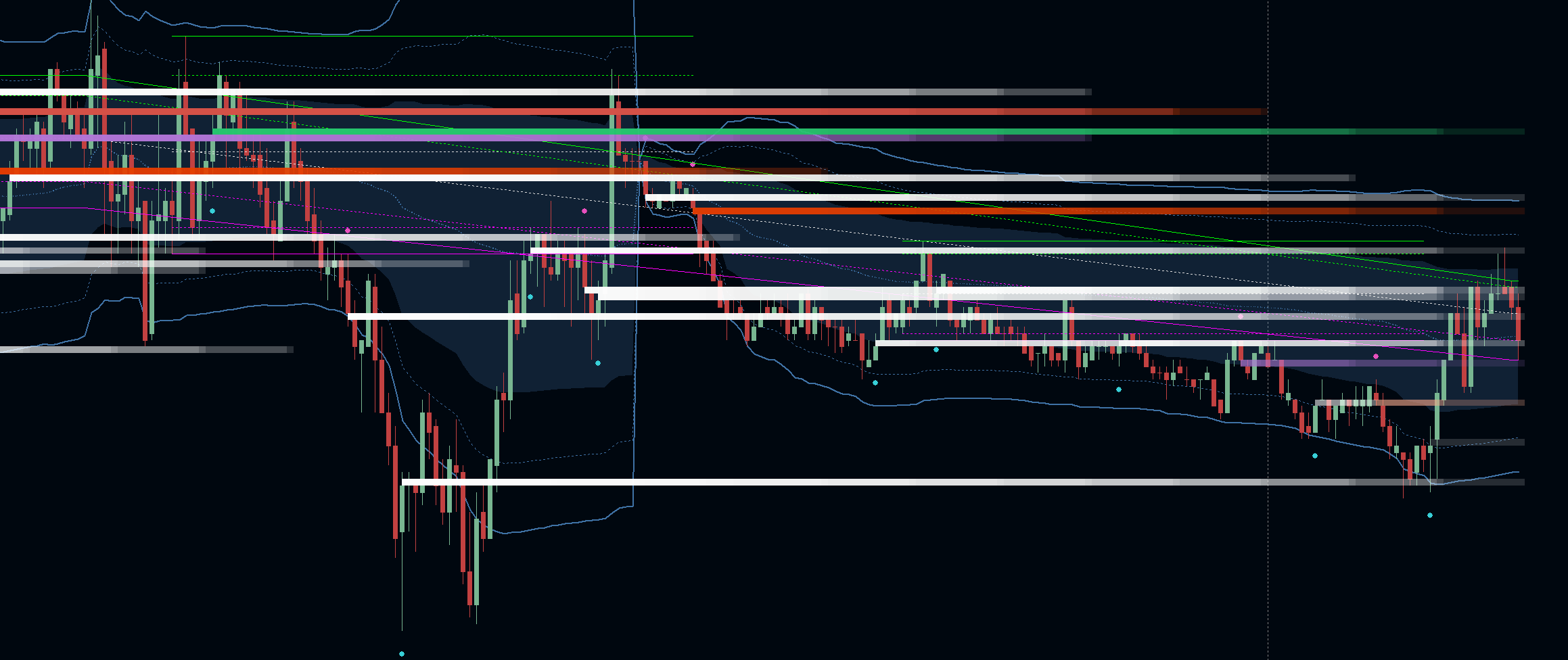

Image 2: Starting replay fresh.

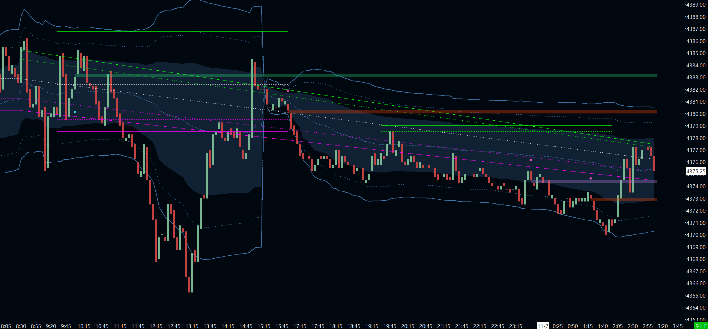

Image 3: As replay continues.
